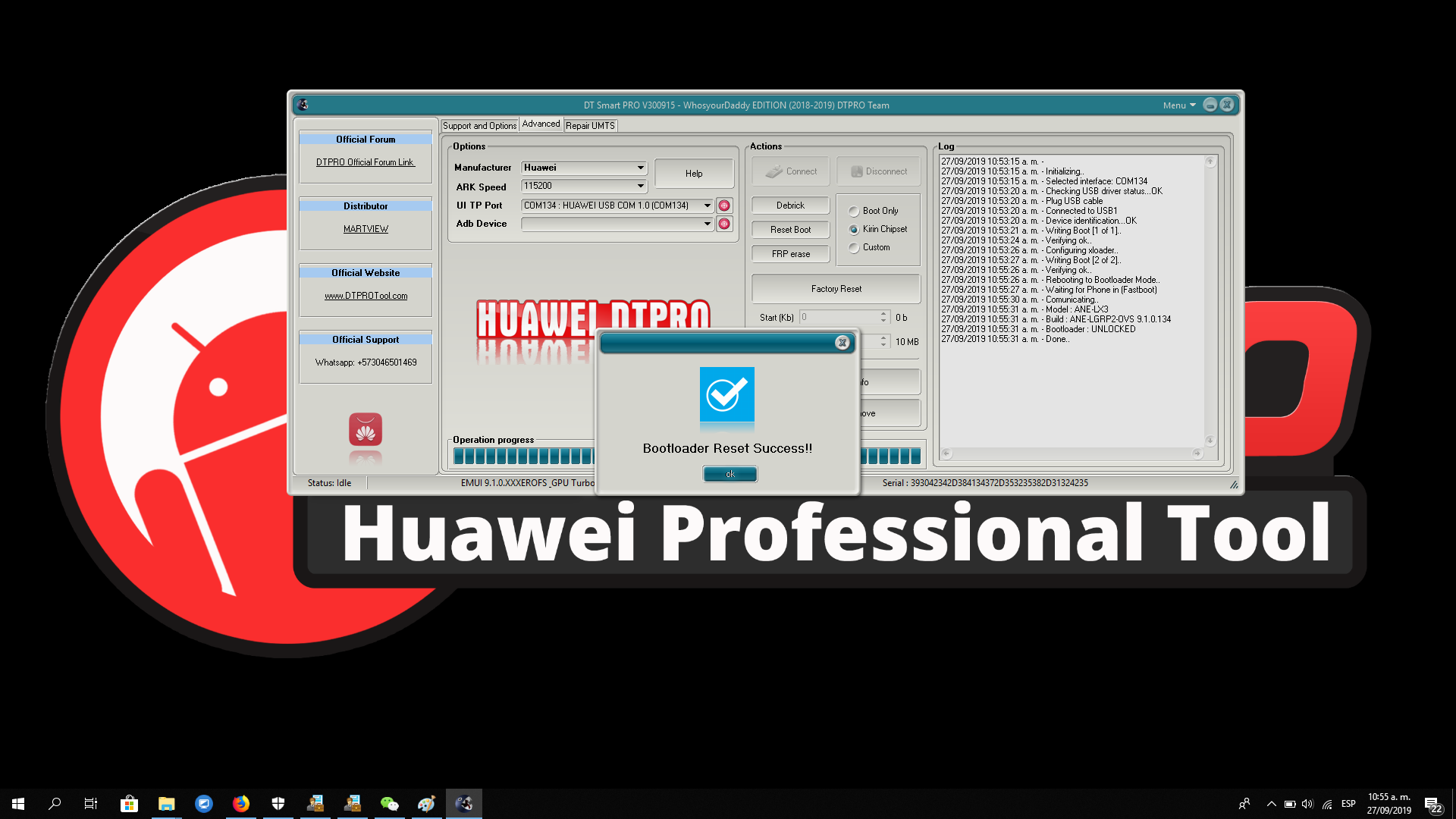

Reseting Bootloader in Huawe ANE-LX!
ANdroid 9.1.0.040 Supported
Make Testpoint And Select Huawei USB COM 1.0 in UI TP port
27/09/2019 10:53:15 a. m. -
27/09/2019 10:53:15 a. m. - Initializing..
27/09/2019 10:53:15 a. m. - Selected interface: COM134
27/09/2019 10:53:20 a. m. - Checking USB driver status...OK
27/09/2019 10:53:20 a. m. - Plug USB cable
27/09/2019 10:53:20 a. m. - Connected to USB1
27/09/2019 10:53:20 a. m. - Device identification...OK
27/09/2019 10:53:21 a. m. - Writing Boot [1 of 1]..
27/09/2019 10:53:24 a. m. - Verifying ok..
27/09/2019 10:53:26 a. m. - Configuring xloader..
27/09/2019 10:53:27 a. m. - Writing Boot [2 of 2]..
27/09/2019 10:55:26 a. m. - Verifying ok..
27/09/2019 10:55:26 a. m. - Rebooting to Bootloader Mode..
27/09/2019 10:55:27 a. m. - Waiting for Phone in (Fastboot)
27/09/2019 10:55:30 a. m. - Comunicating..
27/09/2019 10:55:31 a. m. - Model : ANE-LX3
27/09/2019 10:55:31 a. m. - Build : ANE-LGRP2-OVS 9.1.0.134
27/09/2019 10:55:31 a. m. - Bootloader : UNLOCKED
27/09/2019 10:55:31 a. m. - Done..
"After Reset Bootloader phone will be to reset in FastBoot Mode"

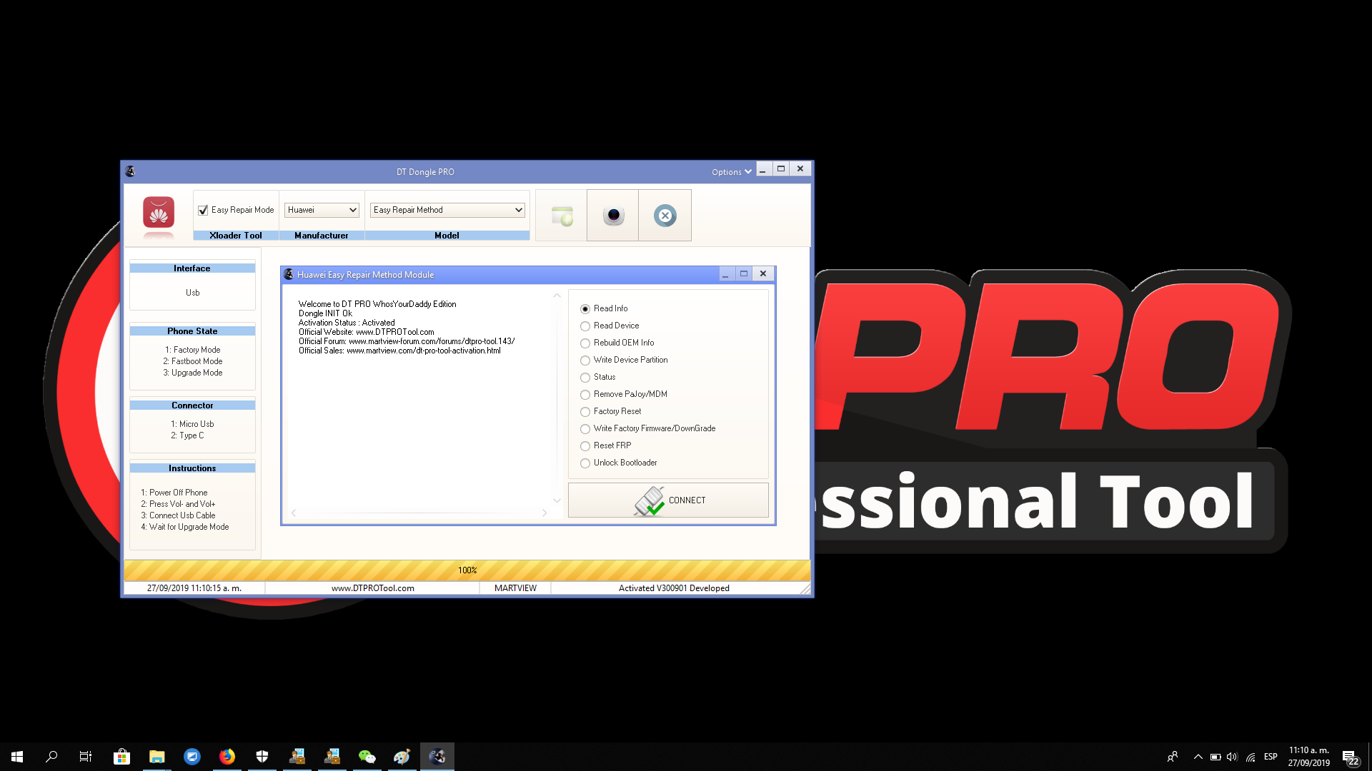

Now Open DT programer "the Last Version"
Now Tick Read Device and click in Conect
Selected interface: USB (KIRIN)

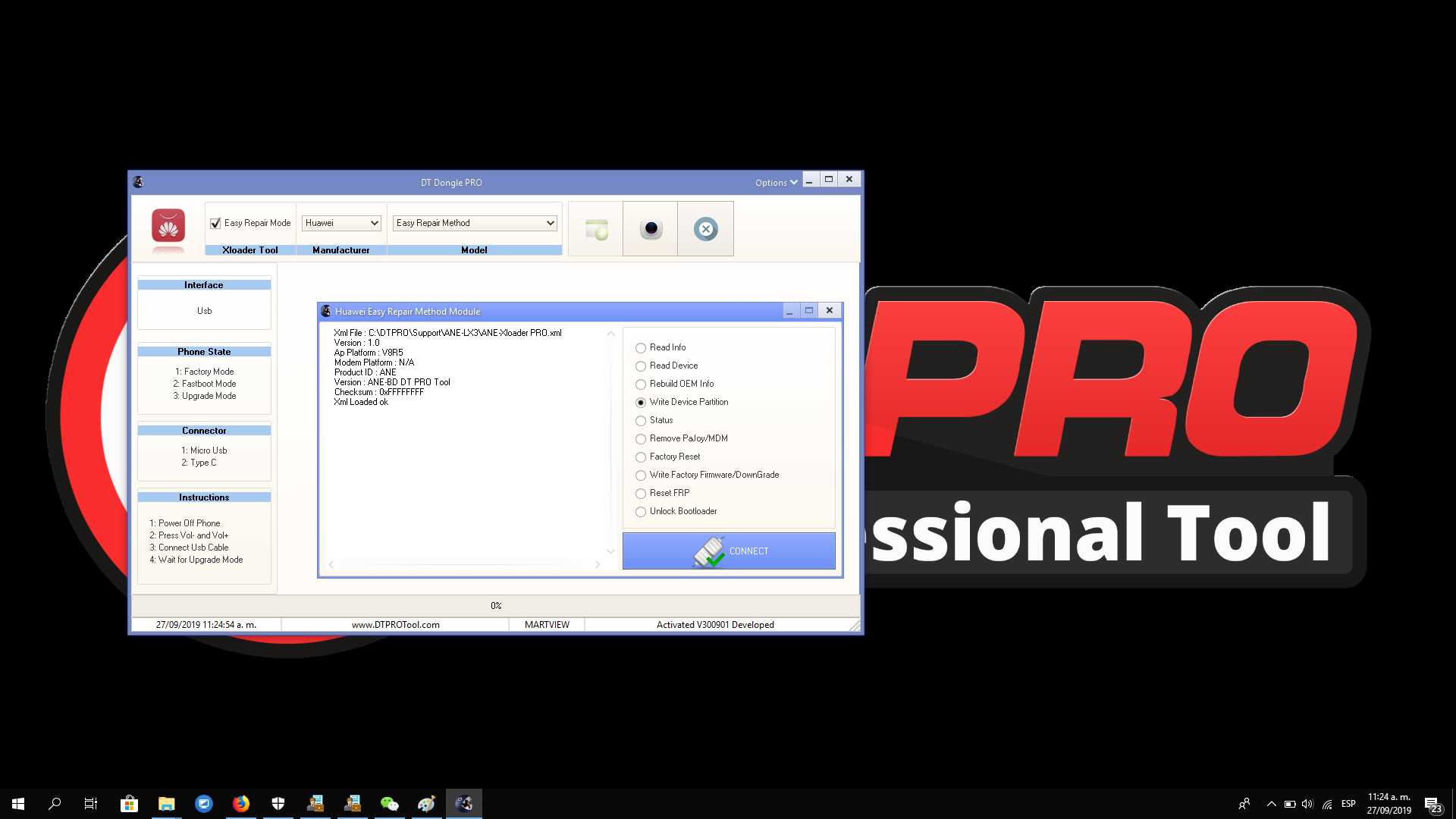

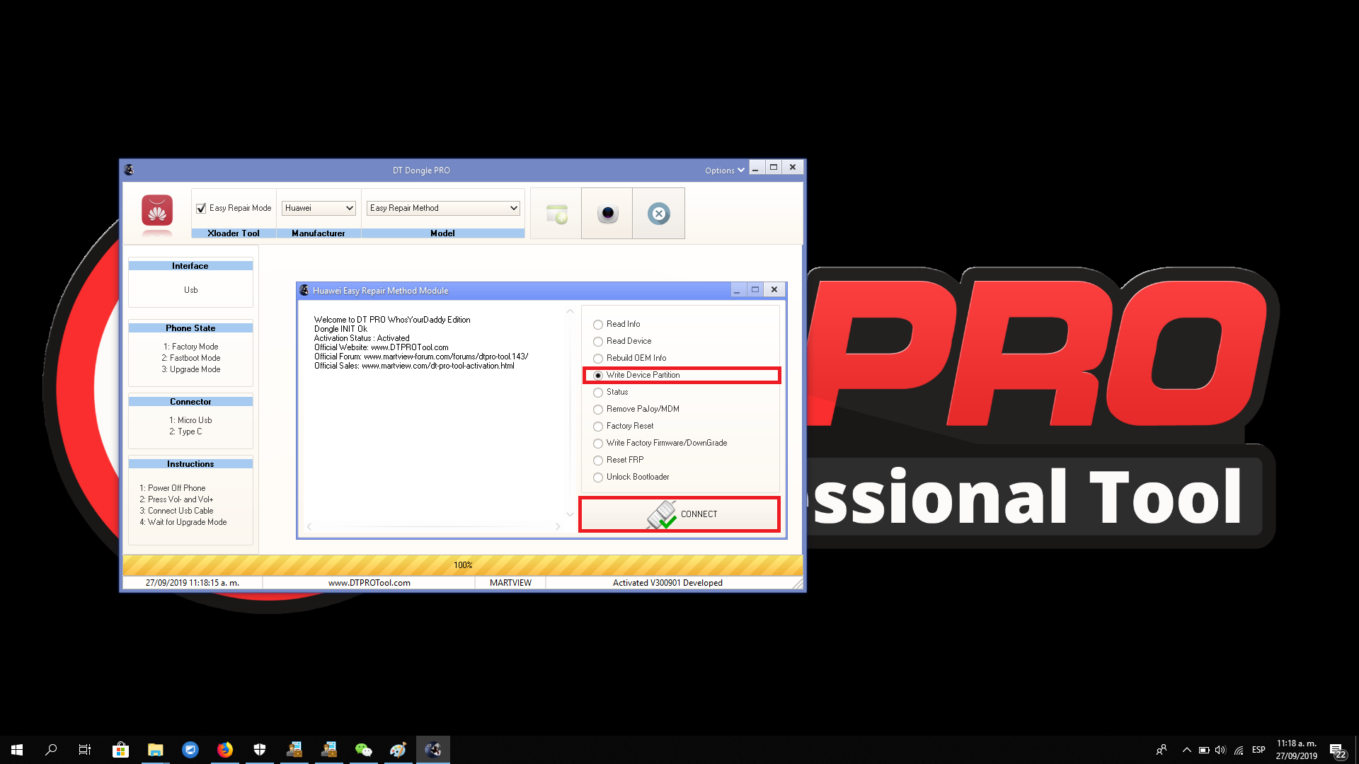

Now tick Write Device Partition & Click in Conect

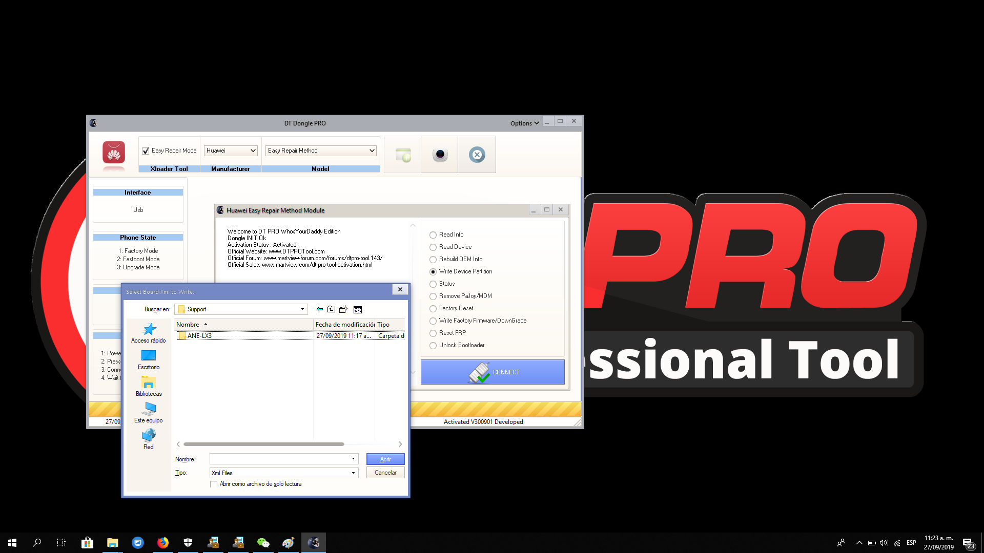

Select Xloader Downloaded from Support
Xloader Selected

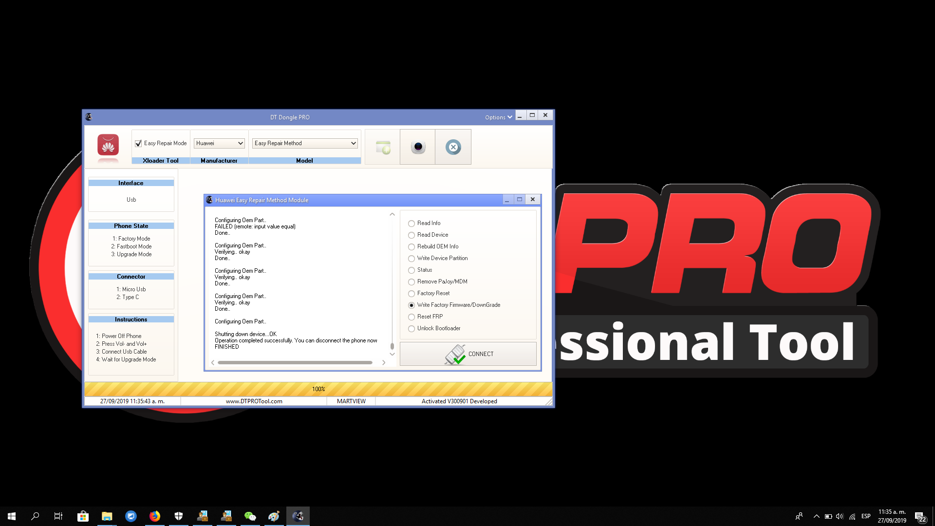

Now tick Write Factory Firmware/DownGrade & Click in connect
Proccessin.....
DownGrade Success

Shutting down device...OK
Operation completed successfully. You can disconnect the phone now
