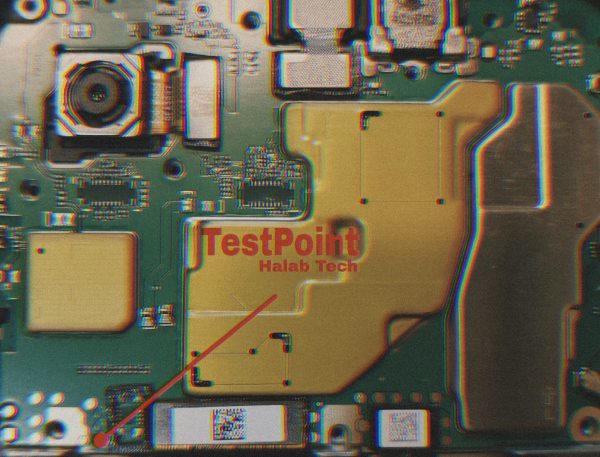

thank you Dtpro team, today i did H X5 FRP Free
first Make TP go to PM tab and "Connect/Get"
