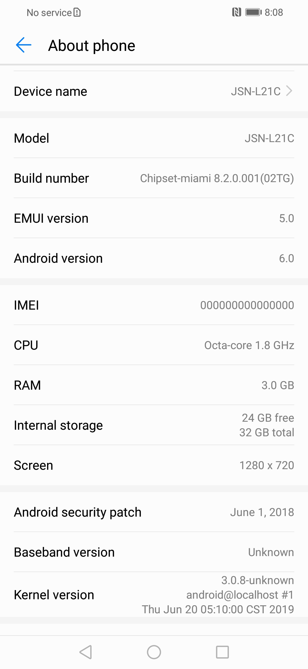

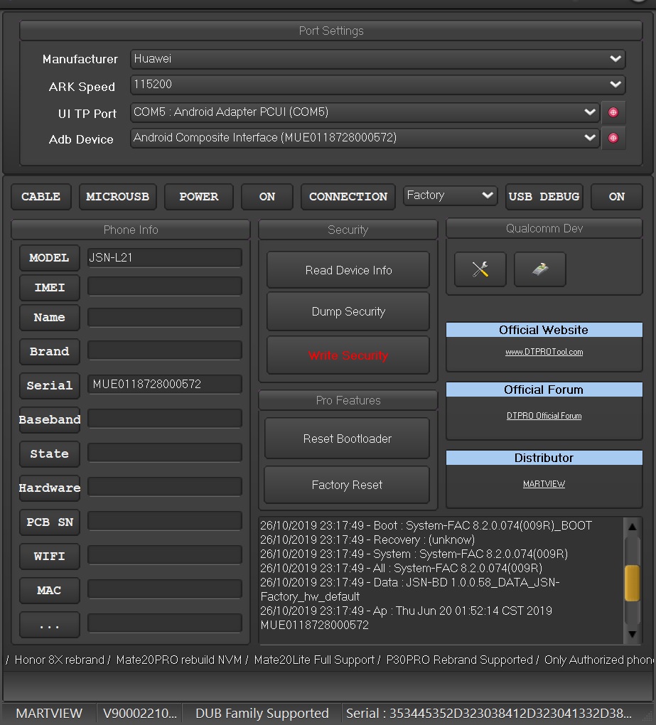

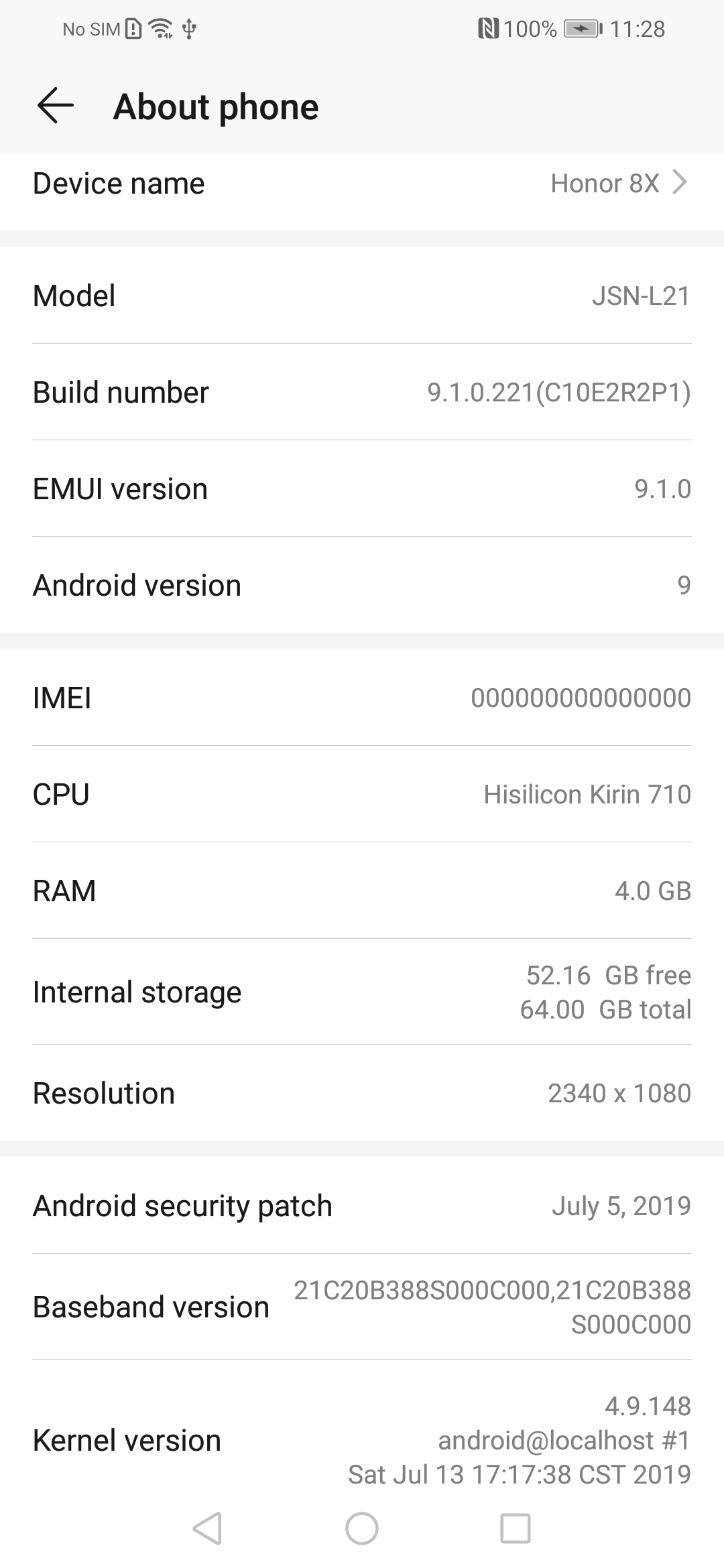

Hi,
i tried IMEI repair with NVreconstructor V9000221019 after buying licence but i cant type anything in the IMEI section.
first i flashed Board firmware using test point.
did i make mistake and this tool isn't support IMEI repair yet?
this is the output from 'read device info':
PCUI Interface Selected : COM5
Switching Phone Mode..
Phone Switched to Selected Mode..
Getting Device Info..
Reading Device Information..
Fastboot : Chipset-miami8.2.0.001(02TG)_FASTBOOT
26/10/2019 23:17:49 - Boot : System-FAC 8.2.0.074(009R)_BOOT
26/10/2019 23:17:49 - Recovery : (unknow)
26/10/2019 23:17:49 - System : System-FAC 8.2.0.074(009R)
26/10/2019 23:17:49 - All : System-FAC 8.2.0.074(009R)
26/10/2019 23:17:49 - Data : JSN-BD 1.0.0.58_DATA_JSN-Factory_hw_default
26/10/2019 23:17:49 - Ap : Thu Jun 20 01:52:14 CST 2019
MUE0118728000572
JSN-L21
Band : 4G
Emmc : 64G
Done..

please check BaseBand "Unknown" - For New IMEI you need write. NEW VN - after this you need write PCB SN and SN that Get from New NV
