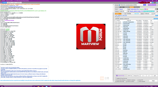

I am having trouble flashing MTK models
especially models like The Redmi Note 8 Pro
I always get the error Wait 4 hours
or similar.
Reinstall the MTK UFI drivers as it is the only tool I use to flash these types of processors.
But I am stuck on that error.
What should I do?

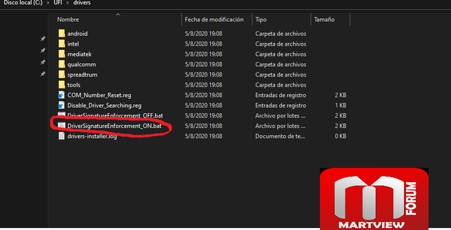

Well i could find the solution to this
What worked for me was the following:
First I went to the Ufi installation folder and look for the file "DriverSignatureEnforcement_ON.bat"
I executed it, and when rebooting and choosing to install unsigned devices (something that I already had on the PC but not because of this file)

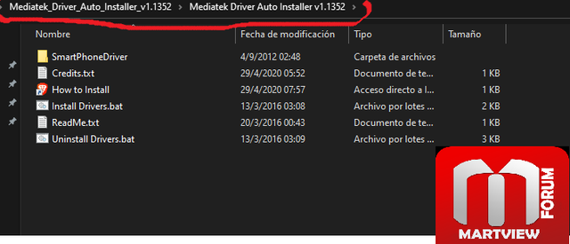

Procedure to install the automatic MTK installer.
After this I was able to flash the Redmi Note 8 pro without any problems in this case
I hope it works for someone else!
Step 1 :
Paso-1
