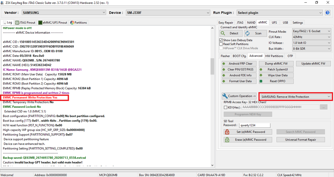

hafiz4saqib
It can`t remove EMMC Permanent Write Protection: Yes
But with TP its showing EMMC Permanent Write Protection: No
And also there is no Update EMMC FW.
How to resolve this issue ?
Or its need new eMMC.

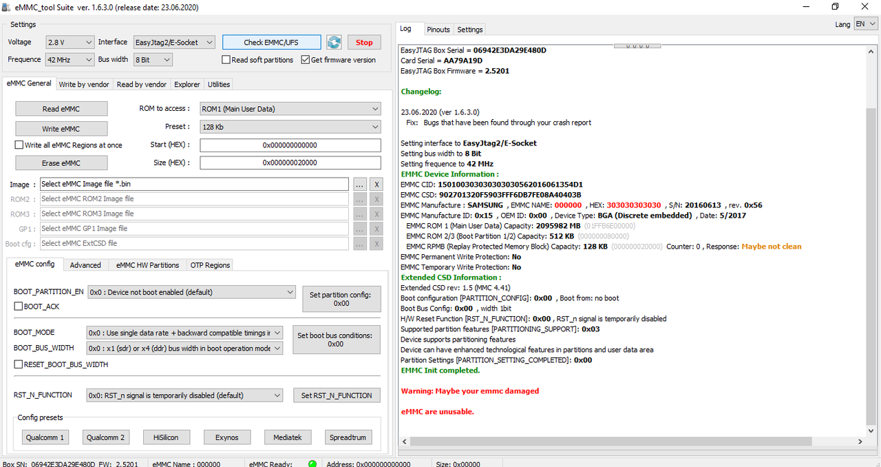

But in Easy Jtag PLus suite showing that EMMC are unsueable when I connect with TP.

---------- eMMC Device Information ----------
eMMC CID : 150100514536334D42009F6C96945501
eMMC CSD : D02701320F5903FFF6DBFFEF8E406069
eMMC Manufacturer ID: 0015 , OEM ID: 0100
eMMC Date: 05/2018  Rev.0x0
eMMC NAME: QE63MB , S/N: 2674693780
eMMC NAME (HEX): 514536334D42
IC Name: Samsung , KMQE60013M-B318/16GB @BGA221
EMMC ROM1 (Main User Data)   Capacity: 15028 MB
EMMC ROM2 (Boot Partition 1) Capacity: 4096 kB
EMMC ROM3 (Boot Partition 2) Capacity: 4096 kB
EMMC RPMB (Replay Protected Memory Block) Capacity: 16384 kB
EMMC RPMB is programmed and written 2 times
EMMC Temporary Write Protection: No
EMMC Password Locked: No
  Extended CSD rev 1.8 (MMC 5.1)
Boot configuration [PARTITION_CONFIG: 0x00] No boot partition configured.
Boot bus config [177]: 0x01 , width 4bits  , Partition config [179]: 0x00.
H/W reset function [RST_N_FUNCTION]: 0x00
High-capacity WP group size [HC_WP_GRP_SIZE: 0x00004000]
Partitioning Support [PARTITIONING_SUPPORT]: 0x07
 Device support partitioning feature
 Device can have enhanced tech.
Partitioning Setting [PARTITION_SETTING_COMPLETED]: 0x00
Backup saved: QE63MB_2674693780_20200713_0558.extcsd

Running:SAMSUNG: Remove Write Protection...
Z3X EasyJtag Software ver. 3.7.0.11
Skip loading eMMC Addon Firmware
Box IO Level:1800 mV
CLK Rate:14000 kHz
Removing write protection...
Done.
Backup saved: QE63MB_2674693780_20200713_0600.extcsd

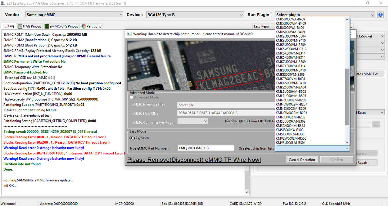

Log with TP
Loading eMMC GEN2 Firmware... IO: 1800 mV
Initial pull results:
  clock: 971mV pin connected ok
  command: 976mV pin connected ok
  data0: 977mV pin connected ok
  data1: 972mV pin connected ok
  data2: 974mV pin connected ok
  data3: 975mV pin connected ok
  data4: 976mV pin connected ok
  data5: 976mV pin connected ok
  data6: 975mV pin connected ok
  data7: 974mV pin connected ok
Box S/N: 06942E3DA29E480D, ,FW Ver.: 02.52
CLK Rate:42000 kHz
Bus Width:8bit,SDR
HiPower mode is off!
eMMC CID : 150100303030303030562016061354D1
eMMC CSD : 902701320F5903FFF6DB7FE08A40403B
eMMC Date: 05/2017  Rev.0x56
eMMC NAME: 000000 , S/N:  538314259
eMMC NAME (HEX): 303030303030
EMMC ROM1 (Main User Data)   Capacity: 2095982 MB
EMMC ROM2 (Boot Partition 1) Capacity: 512 kB
EMMC ROM3 (Boot Partition 2) Capacity: 512 kB
EMMC RPMB (Replay Protected Memory Block) Capacity: 128 kB
EMMC RPMB is not yet programmed (clear) or RPMB General failure
  Extended CSD rev 1.5 (MMC 4.41)
Boot bus config [177]: 0x00 , width 1bit  , Partition config [179]: 0x00.
High-capacity WP group size [HC_WP_GRP_SIZE: 0x00000000]
Partitioning Support [PARTITIONING_SUPPORT]: 0x03
Backup saved: 000000_ 538314259_20200713_0619.extcsd
Blocks Reading Error (0x0 , 1 , Reason: DATA RCV Timeout Error )
Blocks Reading Error (0x200 , 1 , Reason: DATA RCV Timeout Error )
Warning! Read error 0 strange behavior now likely!
Blocks Reading Error (0x1FFB6DFFE00 , 1 , Reason: DATA RCV Timeout Error )
Partition info not found
Done.
