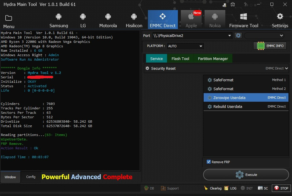

FRP-Security reset using EMMC option successfully done by Hydra Main Tool
1. Run Hydra Main Tool
2. Choose "EMMC Direct" Tab
3. Connect device with Hydra EMMC (or JTAG) Tool
4. Choose "Platform" as AUTO
5. Click on "Service"
6. Click on "Security Reset" from drop down menu
7. Choose on "Zero wipe userdata"
8. Tick "Remove FRP" from EMMC Direct.
9. Click on "Execute"
10. Wait until the operation is complete.
