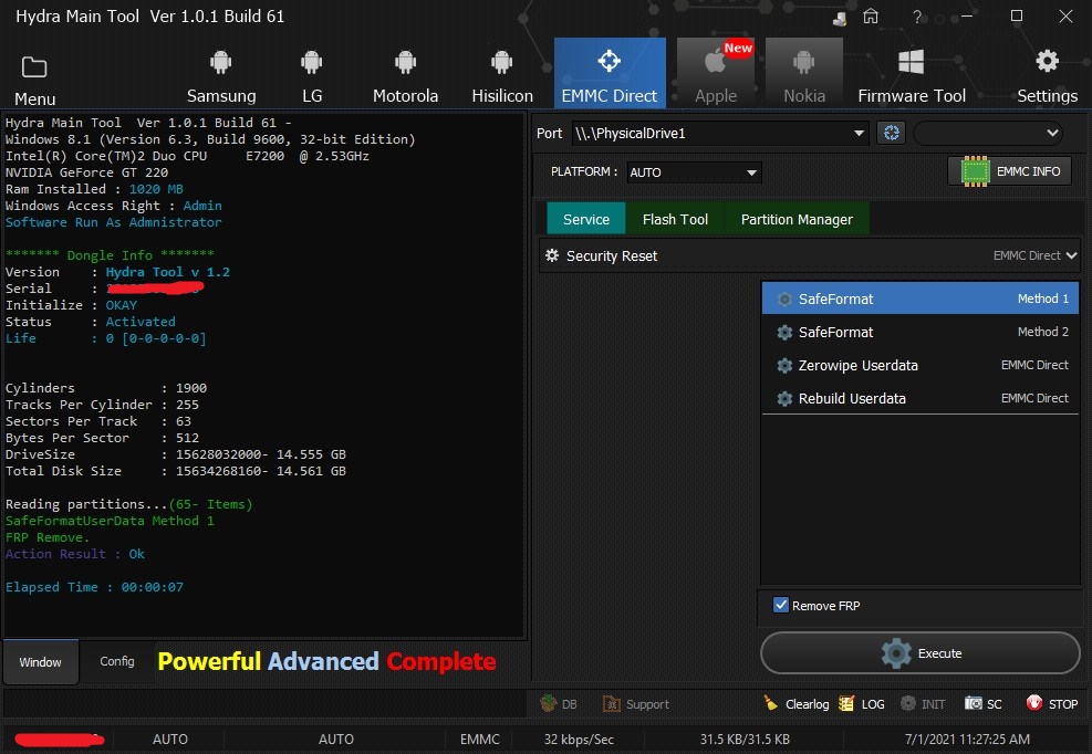

FRP and Format using Direct EMMC successfully removed by Hydra Main Tool
1. Run Main Tool of Hydra.
2. Choose "EMMC Direct" Tab.
3. Choose Platform as "Auto"
4. Dissemble cellphone or device
5. Connect it with wires as different places (as you have to do with EMMC)
6. Now, connect it with computer using usb cable.
7. Choose Port as it shows in your computer. Here is PhysicalDrive1.
8. Go to "Service"
9. Choose "Security Reset" from drop down menu.
10. Choose "Safe Format"
11. Tick "Remove FRP" just above "Execute" button
12. Click on "Execute" button
13. Wait until the operation is computed.
