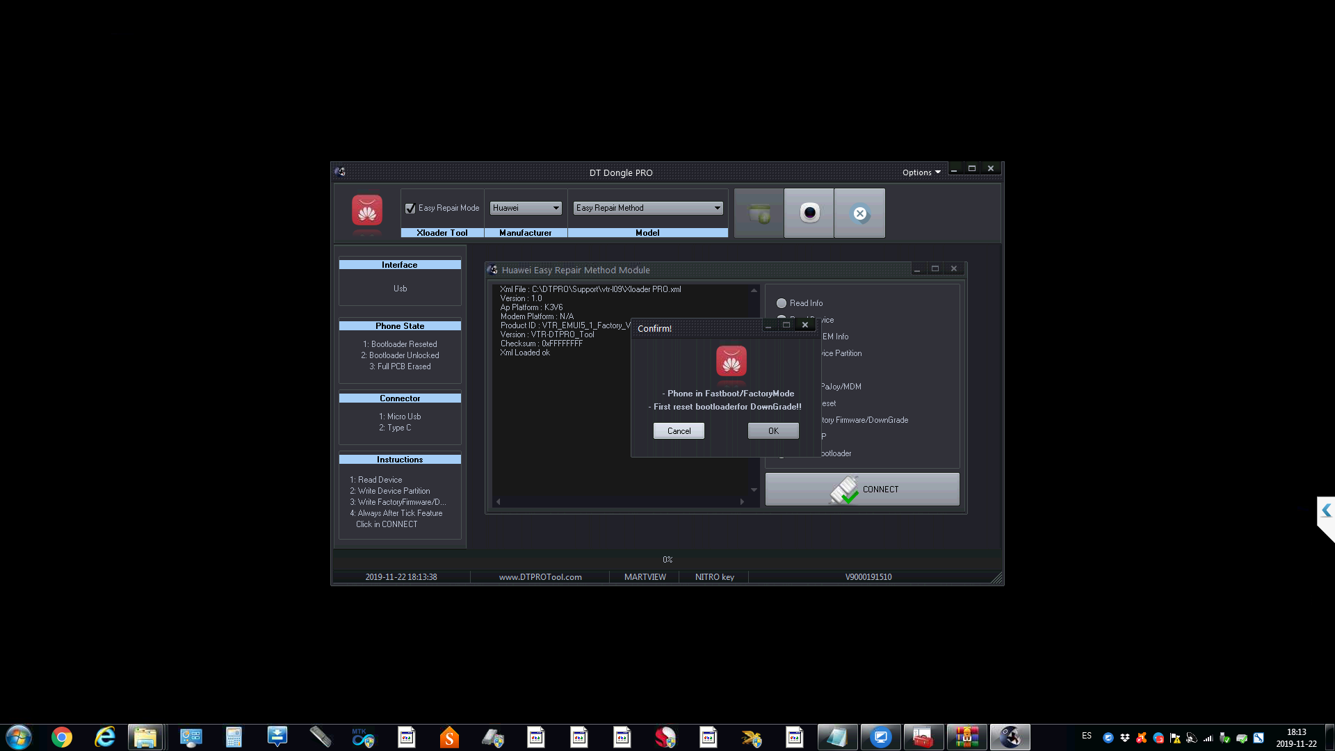

i can't write the xloader.
23/11/2019 06:57:37 p.m. -
23/11/2019 06:57:37 p.m. - Initializing..
23/11/2019 06:57:37 p.m. - Selected interface: COM233
23/11/2019 06:57:38 p.m. - Checking USB driver status...OK
23/11/2019 06:57:38 p.m. - Plug USB cable
23/11/2019 06:57:38 p.m. - Connected to USB1
23/11/2019 06:57:38 p.m. - Device identification...OK
23/11/2019 06:57:39 p.m. - Writing Boot [1 of 1]..
23/11/2019 06:57:41 p.m. - Verifying ok..
23/11/2019 06:57:44 p.m. - Configuring xloader..
23/11/2019 06:57:45 p.m. - Writing Boot [2 of 2]..
23/11/2019 06:59:42 p.m. - Verifying ok..
23/11/2019 06:59:42 p.m. - Rebooting to Bootloader Mode..
23/11/2019 06:59:43 p.m. - Waiting for Phone in (Fastboot)
23/11/2019 07:00:35 p.m. - Comunicating..
23/11/2019 07:00:35 p.m. - Model : VTR-L09
23/11/2019 07:00:36 p.m. - Build : VTR-L09 9.0.1.210(C25E3R1P8)
23/11/2019 07:00:36 p.m. - Bootloader : LOCKED
23/11/2019 07:00:36 p.m. - Done..
Initializing..
Selected interface: USB (KIRIN)
Checking USB driver status...OK (Kirin Flash Device 2.01.02.00)
Plug USB cable
Connected to USB1
Comunicating..
Sending Preloader...OK
Sending IDloader...OK
Detecting flash type...OK
Model : VTR-L09
Total Files to Process : 33
Writing Partition : ptable
Max Write Size : 471859200 bytes
Uploading : ptable [196 KB]
Verifying.. okay
Writing : ptable
FAILED (remote: Command not allowed)
Done..
Writing Partition : xloader
Uploading : xloader [151 KB]
Verifying.. okay
Writing : xloader
Done..
Writing Partition : fastboot
Uploading : fastboot [3634 KB]
Verifying.. okay
Writing : fastboot
Done..
Writing Partition : vector
Uploading : vector [1181 KB]
Verifying.. okay
Writing : vector
Done..
Writing Partition : boot
Uploading : boot [17704 KB]
Verifying.. okay
Writing : boot
Done..
Writing Partition : recovery
Uploading : recovery [41004 KB]
Verifying.. okay
Writing : recovery
Done..
Erasing : cust
Done..
Erasing : misc
Done..
Writing Partition : cache
Uploading : cache [6248 KB]
Verifying.. okay
Writing : cache
Done..
Writing Partition : fw_lpm3
Uploading : fw_lpm3 [216 KB]
Verifying.. okay
Writing : fw_lpm3
Done..
Writing Partition : fw_hifi
Uploading : fw_hifi [4965 KB]
Verifying.. okay
Writing : fw_hifi
Done..
Writing Partition : teeos
Uploading : teeos [3949 KB]
Verifying.. okay
Writing : teeos
Done..
Writing Partition : trustfirmware
Uploading : trustfirmware [161 KB]
Verifying.. okay
Writing : trustfirmware
Done..
Writing Partition : sensorhub
Uploading : sensorhub [1184 KB]
Verifying.. okay
Writing : sensorhub
Done..
Writing Partition : dts
Uploading : dts [8158 KB]
Verifying.. okay
Writing : dts
Done..
Writing Partition : modem_fw
Uploading : modem_fw [57344 KB]
Verifying.. okay
Writing : modem_fw
Done..
Writing Partition : modemnvm_update
Uploading : modemnvm_update [38319 KB]
Verifying.. okay
Writing : modemnvm_update
Done..
Writing Partition : isp_firmware
Writing Partition : reserved4
Uploading : reserved4 [30460 KB]
Verifying.. okay
Writing : reserved4
Done..
Writing Partition : system
Uploading : sparse [460816 KB]
Verifying.. okay
Writing : system
Done..
Writing Partition : vendor
Uploading : sparse [460843 KB]
Verifying.. okay
Writing : vendor
Done..
Erasing : product
Done..
Writing Partition : product
Uploading : product [179899 KB]
Verifying.. okay
Writing : product
Done..
Erasing : version
Done..
Writing Partition : version
Uploading : version [5272 KB]
Verifying.. okay
Writing : version
Done..
Writing Partition : userdata
Uploading : userdata [264193 KB]
Verifying.. okay
Writing : userdata
Done..
Erasing : modemnvm_factory
Done..
Configuring Oem Part..
Done..
Done..
Done..
Writing Partition : ufs_fw
Uploading : ufs_fw [5831 KB]
Verifying.. okay
Writing : ufs_fw
Done..
Shutting down device...OK
Operation completed successfully. You can disconnect the phone now
FINISHED
jrrueda
Sep 24, 2019
16
3

this log is latest version of smart pro.
26/11/2019 03:56:19 p.m. -
26/11/2019 03:56:19 p.m. - Initializing..
26/11/2019 03:56:19 p.m. - Selected interface: COM171
26/11/2019 03:56:20 p.m. - Checking USB driver status...OK
26/11/2019 03:56:20 p.m. - Plug USB cable
26/11/2019 03:56:20 p.m. - Connected to USB1
26/11/2019 03:56:20 p.m. - Device identification...OK
26/11/2019 03:56:21 p.m. - Writing Boot [1 of 1]..
26/11/2019 03:56:24 p.m. - Verifying ok..
26/11/2019 03:56:27 p.m. - Configuring xloader..
26/11/2019 03:56:28 p.m. - Writing Boot [2 of 2]..
26/11/2019 03:58:18 p.m. - Verifying ok..
26/11/2019 03:58:18 p.m. - Rebooting to Bootloader Mode..
26/11/2019 03:58:19 p.m. - Waiting for Phone in (Fastboot)
26/11/2019 04:00:27 p.m. - Comunicating..
26/11/2019 04:00:27 p.m. - Model : VTR-L09
26/11/2019 04:00:28 p.m. - Build : VTR-L09 8.0.0.310(C25)
26/11/2019 04:00:28 p.m. - Serial : WPG0217908000321
26/11/2019 04:00:28 p.m. - Imei : 865545031830308
26/11/2019 04:00:28 p.m. - Imei : 1865545031830308
26/11/2019 04:00:28 p.m. - MEID : 86554503183030
26/11/2019 04:00:28 p.m. - Bootloader : LOCKED
26/11/2019 04:00:28 p.m. - Done..

jrrueda
Sep 24, 2019
16
3
29/11/2019 03:18:07 p.m. -
29/11/2019 03:18:07 p.m. - Initializing..
29/11/2019 03:18:07 p.m. - Selected interface: COM171
29/11/2019 03:18:08 p.m. - Checking USB driver status...OK
29/11/2019 03:18:08 p.m. - Plug USB cable
29/11/2019 03:18:08 p.m. - Connected to USB1
29/11/2019 03:18:08 p.m. - Device identification...OK
29/11/2019 03:18:09 p.m. - Writing Boot [1 of 1]..
29/11/2019 03:18:11 p.m. - Verifying ok..
29/11/2019 03:18:14 p.m. - Configuring xloader..
29/11/2019 03:18:16 p.m. - Writing Boot [2 of 2]..
29/11/2019 03:20:36 p.m. - Verifying ok..
29/11/2019 03:20:36 p.m. - Rebooting to Bootloader Mode..
29/11/2019 03:20:37 p.m. - Waiting for Phone in (Fastboot)
29/11/2019 03:21:11 p.m. - Comunicating..
29/11/2019 03:21:11 p.m. - Model : VTR-L09
29/11/2019 03:21:12 p.m. - Build : VTR-L09 9.1.0.252(C45E6R1P9)
29/11/2019 03:21:12 p.m. - Bootloader : LOCKED
29/11/2019 03:21:12 p.m. - Done..
today I got another vtr--09 and it was not possible to unlock the boot.
