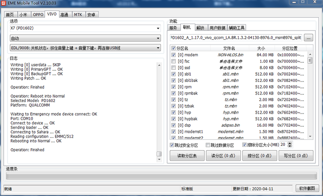

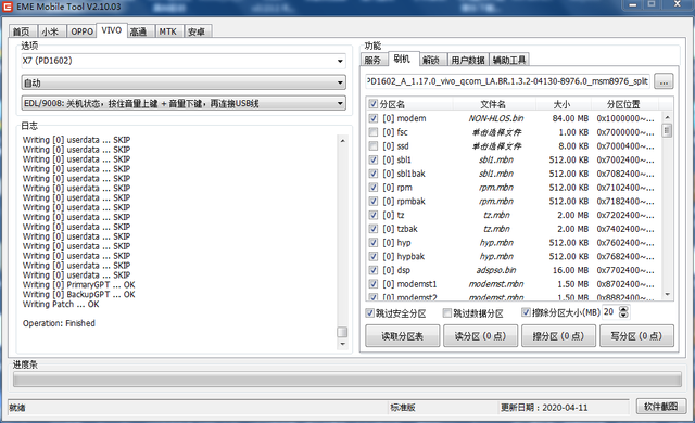

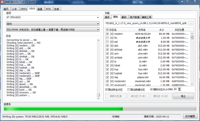

Case: VIVO X7 (PD1602) stuck on logo
Demand: Flash
Operation process:
1.Go to Flash Tab, select ROMs
2.Press "Write"
3.Enter Qualcomm EDL/9008 mode connect USB Cable (install drivers)
4.Waiting for the operation to complete
