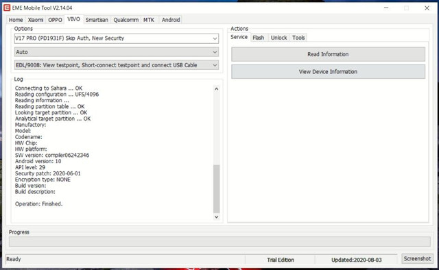

EMT-VIVO V17 PRO (PD1931F, 20200601, 10) Factory Reset
Case: VIVO V17 PRO (PD1931F, 20200601, 10) Screen lock
Demand: Factory Reset
Operation process:
1.Go to Service Tab
2.Press "Factory Reset"
3.Enter Qualcomm EDL/9008 mode connect USB Cable (install drivers)
4.Waiting for the operation to complete

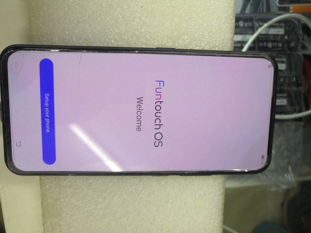

TIPS: If phone can not turn on after factory reset for vivo latest version, go to recovery mode and then do wipe data and cache operation please.
