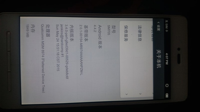

EMT-Smartisan T1 (SM705, 4.4.2) Read Userdata from stuck phone + Read Screenlocks
Case: Smartisan T1 (SM705, 4.4.2) phone stuck
Demand: Read userdatas
Operation Process:

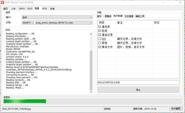

1.Read Userdata

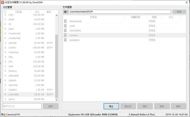

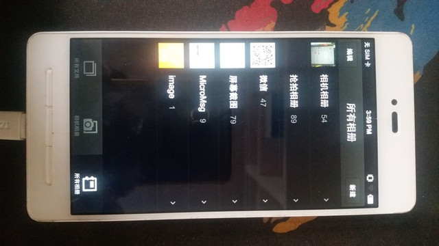

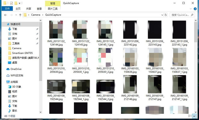

2.The phone turned on after do export & delete "Camera" directory part of files (clear the phone space)

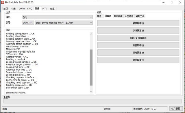

3.Forgot the phone screen lock, read screenlocks
4.All done, problem solved
