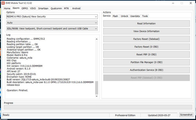

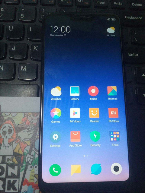

EMT-REDMI 6 PRO (SAKURA, MIUI10.2.6.0, 8.1.0) Stuck on recovery mode solve by flashing with auth service
Case: REDMI 6 PRO (SAKURA, MIUI10.2.6.0, 8.1.0) stuck on recovery
Demand: Authentication Service + Flashing
Operation process:

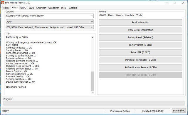

1.Enter Qualcomm EDL/9008 mode connect USB Cable (install drivers)
2.Go to Service Tab, Press "Authentication Service"

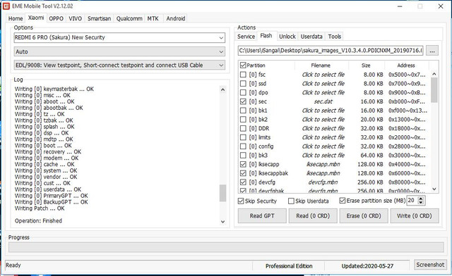

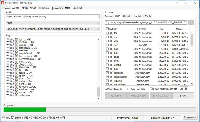

3.Go to Flash Tab, Select ROMs and press "Write"
4.Waiting for the operation to complete
