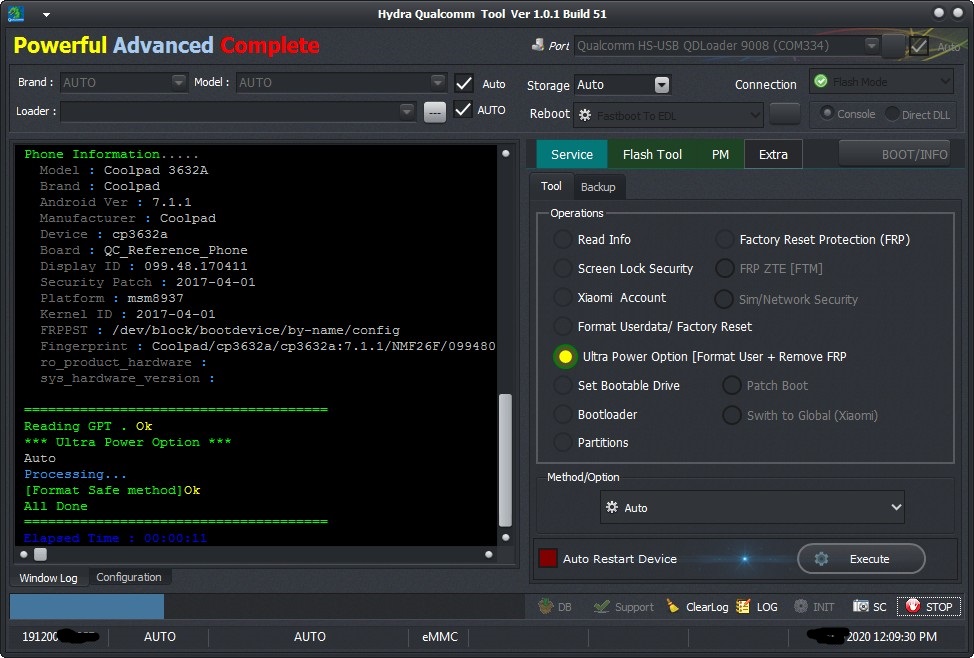

Coolpad 3632A Remove Google account by hydra dongle
Firehose Loader[cool_1_6.mbn]
Sending ...................Ok
Finding EDL Port..[COM334]
Connecting to Firehose...
Ping... Ok
Configuration......Ok
Chip Configuration :
MemoryName : eMMC
MaxXMLSizeInBytes : 4096
TargetName : 8917
Version : 1
* STORAGE DEVICE INFO *
Memory Type : eMMC
Block Size in Bytes : 512
Page Size : 512
Manufacturer ID : 21
Serial Number : 3452227215
Firmware Version : 6
Product Name : FNX2MB
Physical Partitions : 3
Total Logical Blocks:
Drive [0] 15269888[7.281 GB]
Drive [1] 8192[4 MB]
Drive [2] 8192[4 MB]
Running : Ok
Reading GPT . Ok
Phone Information.....
Model : Coolpad 3632A
Brand : Coolpad
Android Ver : 7.1.1
Manufacturer : Coolpad
Device : cp3632a
Board : QC_Reference_Phone
Display ID : 099.48.170411
Security Patch : 2017-04-01
Platform : msm8937
Kernel ID : 2017-04-01
Fingerprint : Coolpad/cp3632a/cp3632a:7.1.1/NMF26F/099480857:user/release-keys
ro_product_hardware :
sys_hardware_version :
Reading GPT . Ok
* Ultra Power Option *
Auto
Processing...
[Format Safe method]Ok
All Done
Elapsed Time : 00:00:11
