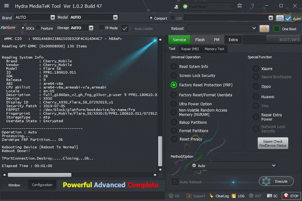

Hydra Cherry mobile Flare S8 FRP successfully removed by Hydra Tool
546
Brand : AUTO Model : AUTO Connection : Flash Mode

Reading System Info
Brand : Cherry_Mobile
Vendor : Cherry_Mobile
Model : Flare S8
SDK : 28
Release : 9
ABI : arm64-v8a
Locale : en-US
Description : full_g1860ps_v2_gh_fng_g33scr_p-user 9 PPR1.180610.011 0729122925 release-keys
Device : X930
Display ID : Cherry_X930_Flare_S8_07292019_v1
Security Patch : 2019-07-05
FRPPST : /dev/block/platform/bootdevice/by-name/frp
Fingerprint : Cherry_Mobile/Flare_S8/X930:9/PPR1.180610.011/0729122925:user/release-keys
StorageType : mtp
Userdata State : Encrypted
Autobackup Partitions
-> Renaming Preloader.... preloader_g1860ps_v2_gh_fng_g33scr_p.bin
Creating Scatter file... C:\Hydra Tool\\Backup\Auto\Cherry_Mobile_Flare S8_0690--9_Cherry_X930_Flare_S8_07292019_v1_200121112239\MT6763T_Android_scatter.txt
-frp[0x03588000]1024 KB ->frp.bin...Ok
-nvdata[0x05688000]64 MB ->nvdata.bin...Ok
-persist[0x0D000000]48 MB ->persist.bin...Ok
-nvram[0x17800000]64 MB ->nvram.bin...Ok
Done!!!
UNIQUE ID : DA9AF6CA9B940737D5453A9C3972D922
eMMC CID : 90014A68423861503E020F4C414D44C7 - hB8aP>
Reading System Info
Model : Flare S8
SDK : 28
Release : 9
ABI : arm64-v8a
Locale : en-US
Device : X930
StorageType : mtp
Operation : Auto
Processing...
ZeroWipe FRP Partition... Ok
Reboot Done!!
Elapsed Time : 00:01:00
