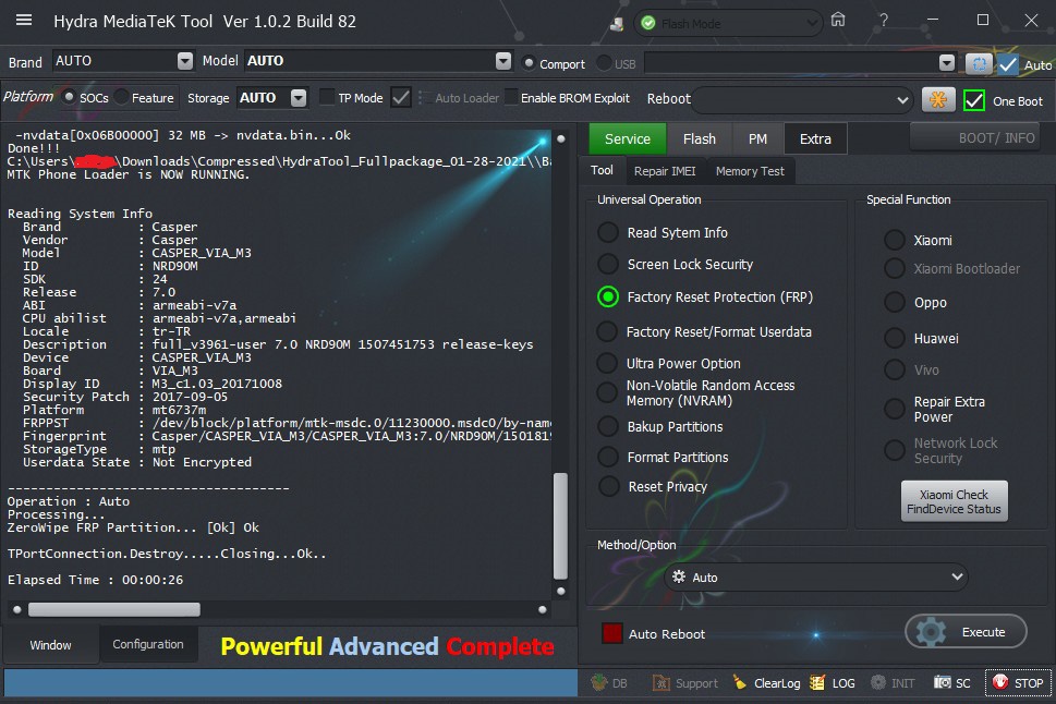

Hydra Casper VIA M3 zero wipe FRP successfully done by Hydra Tool
546
Brand : AUTO Model : AUTO Connection : Flash Mode
Connection
-Please wait...
-Connect Phone...
-Found...
-PreLoader...[COM7]
TPortConnection.Create...(COM7)..Opening...Ok
Handshaking...Ok
Identifying Hardware ID.....
BROM CPUID : 0335MT6737[6735]
Handshaking...
FUSEID : 00000000
SECURE VERSION : 00
BL VERSION : 00
BR Secured : 01
NORMAL BOOT
Preparing Download Agent..
DA : 6735_SWSEC_Wiko.bin
Ver : MTK_AllInOne_DA_v3.3001.00.00
Init : Loader [1]
Sending : Accepted
Identifying Protocol...
Protocol : Old - eMMC
00000000000000000000
PRMMCCID : 484A0190613447423328A5320F1147E8
Init Configuration
Running DA 4.2 on BBID : 0x9B Ok
Initializing Loader [2]
Sending Loader [2] Accepted
Reading Flashchip data....
eMMC USER : 0x0000000747C00000 -29,121 GB
ERAM Size : 0x00000000C0000000 -3 GB
IRAM Size : 0x0000000000020000 -128 KB
UNICAL RID : B326F7ADB1FED4CE01B266881364B3EC
eMMC CID : 484A0190613447423328A5320FA447E8
Change to HIGH SPEED...
5A
Connection
-Please wait...
-Found...[COM101]
Reading Partition Table
SIZE[0x000007E8] 23 Items > Done
Reading System Info
Brand : Casper
Vendor : Casper
Model : CASPER_VIA_M3
SDK : 24
Release : 7.0
ABI : armeabi-v7a
Locale : tr-TR
Description : full_v3961-user 7.0 NRD90M 1507451753 release-keys
Device : CASPER_VIA_M3
Board : VIA_M3
Display ID : M3_c1.03_20171008
Security Patch : 2017-09-05
Platform : mt6737m
FRPPST : /dev/block/platform/mtk-msdc.0/11230000.msdc0/by-name/frp
Fingerprint : Casper/CASPER_VIA_M3/CASPER_VIA_M3:7.0/NRD90M/1501819972:user/release-keys
StorageType : mtp
Autobackup Partitions
-preloader[0x00000000] 512 KB -> preloader.bin...Ok
-> Renaming Preloader.... preloader_v3961.bin
Creating Scatter file... C:\Users\Downloads\Compressed\HydraTool_Fullpackage_01-28-2021\\Backup\Auto\Casper_CASPER_VIA_M3_0335-mt6737m-7.0_M3_c1.03_20171008_220221220742\MT6737_Android_scatter.txt
-nvram[0x00380000] 5 MB -> nvram.bin...Ok
-frp[0x06A00000] 1024 KB -> frp.bin...Ok
-nvdata[0x06B00000] 32 MB -> nvdata.bin...Ok
Done!!!
Reading System Info
Brand : Casper
Vendor : Casper
SDK : 24
Release : 7.0
ABI : armeabi-v7a
Locale : tr-TR
Board : VIA_M3
Platform : mt6737m
StorageType : mtp
Operation : Auto
Processing...
ZeroWipe FRP Partition... [Ok] Ok
Elapsed Time : 00:00:26
