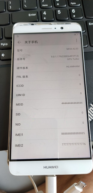

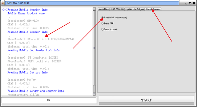

1.check mobile info

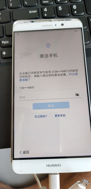

here we take one Huawei mate9 and make sample!!!
when we act mobile, mobile get the account!!!
we can in the Emergency call input * # * #0000# * # * for check mobile version
also we can use mrt read mobile info

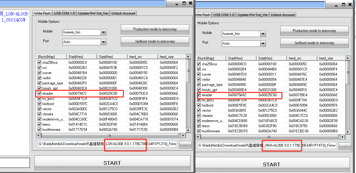

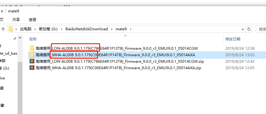

2.find same cpu as mobile,same version mobile flash file;like i can find mate9 and mate9 pro
this two kind mobile they are hisi cpu 960,and have 9.0.1.179 version flash file
we use mrt hwtool select it,in here we need check the xloader
if xloader size is Different,it maybe will kill the phone
tip:even you downgrade or flash differnet flash file,if xloader size not same,it will kill the phone,
but normal if mobile cpu same,version same,the xloader size will same!!!
in here we just make sure 100%
ok,we aleady sure it!!!

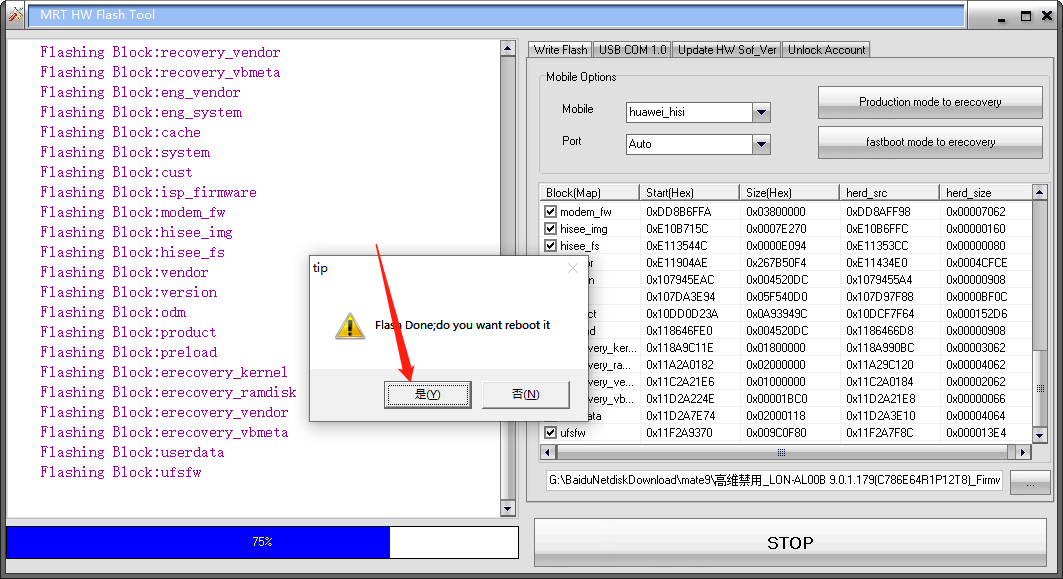

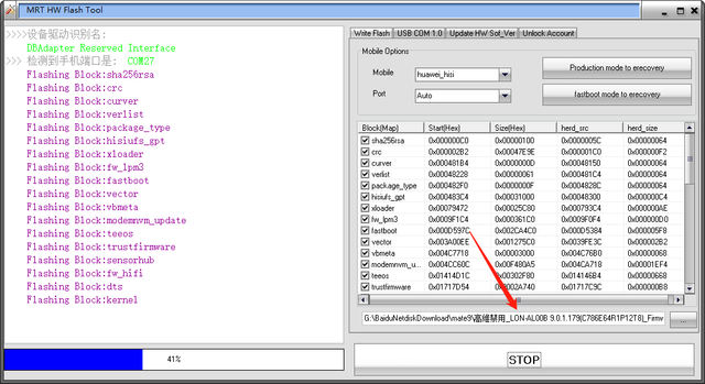

now we flash mate9 mha-al00 to mate9 pro lon-al00

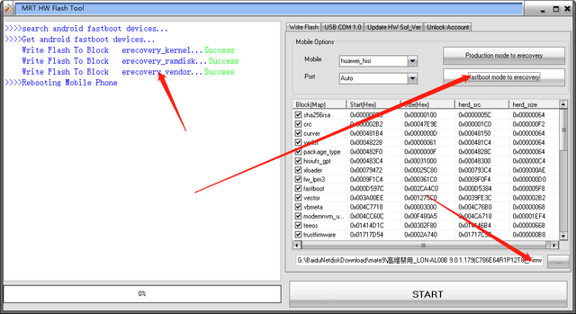

if mobile in fastboot,we need select update.app,
and click fastboot to erecovery
flashing mobile mate9 to mate9 pro
after flash done,we reboot mobile

after flash done
we will see mobile power on,and into system,without activation!!!is great????sure 100%
we input * # * # 0000 # * # * read mobile version again
we can see mobile now is not noraml
we need make it back to mate9
is possible back to mate9 without activation???yes,is true;100%
let see how to do next!!!
now we select mate9 flash file
untick under product all block
let mobile to erecovery mode and flash it
tip;when you flash back the normal mobile flash file,you must be untick under product all the block!!!if not,mobile will format and back to activation
all is done,we reboot mobile now!!!
