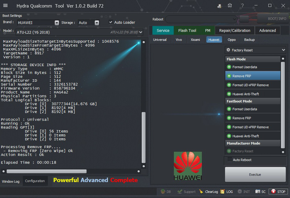

ATU-L22 (Y6 2018) FRP successfully Removed by Hydra Tool
BRPreOperation Configuration
Brand : HUAWEI Model : ATU-L22 (Y6 2018) Storage : Auto
Loader: Huawei-ATU-Y6.mbn
Port : Auto
Connection :
FriendlyName :Qualcomm HS-USB QDLoader 9008 (COM44)
SymbolicName :\??\USB#VID_05C6&PID_9008#5&6d3826b&0&2#{a5dcbf10-6530-11d2-901f-00c04fb951ed}
Driver Ver :08/31/2015,2.1.2.0
Getting device info......
Serial No.: 0x5E6D01F3
MSM ID : 0x000560E1, MSM8917-Qualcomm Snapdragon 425
PBL Ver : 00000000
PK HASH : 6BC369511DA9CADB3A7AF61574F89DB3
85003D6241BDD1FF573DBA61BF6AE119
Firehose Loader[Huawei-ATU-Y6.mbn]
SaharaBoot... Ok
Sending ...................Ok
Connecting to Firehose...
Ping... Ok
Configuration......
Identifying Chip....
Ok
Chip Configuration :
MemoryName : eMMC
MaxXMLSizeInBytes : 4096
TargetName : 8917
Version : 1
*** STORAGE DEVICE INFO ***
Memory Type : eMMC
Block Size in Bytes : 512
Page Size : 512
Manufacturer ID : 144
Serial Number : 3326153782
Firmware Version : 858796104
Product Name : HAG4a2
Physical Partitions : 3
Total Logical Blocks:
Drive [0] 30777344[14.676 GB]
Drive [1] 8192[4 MB]
Drive [2] 8192[4 MB]
Protocol : Universal
Running : Ok
Reading GPT[3]
Drive [0] 56 Items
Drive [1] 0 Items
Drive [2] 0 Items
Processing Remove FRP....
- Removing FRP [Zero Wipe] Ok
Action Result : Ok
Elapsed Time : 00:00:18
