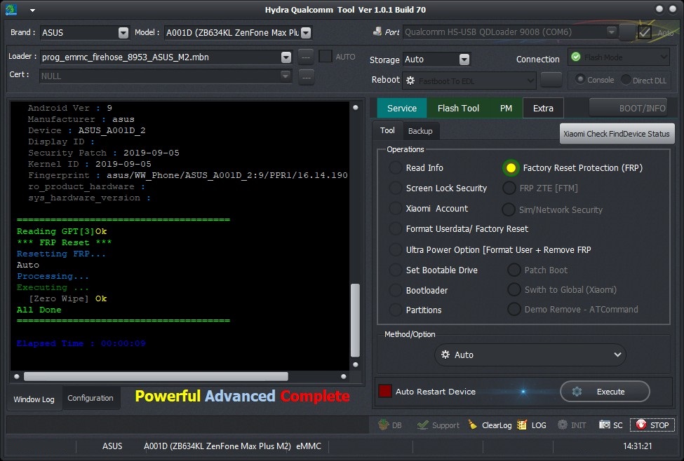

Asus A001D ZB634KL ZenFone Max Plus M2 Google Account Remove by Hydra Tool
  1. Run Hydra Qualcomm Module
  2. Untick auto Select Brand and model
  3. Go to service tab, tick factory reset protection (frp)
  4. click execute and wait for frp operation complete
PreOperation Configuration
Brand : ASUS Model : A001D (ZB634KL ZenFone Max Plus M2) Storage : Auto
Loader: prog_emmc_firehose_8953_ASUS_M2.mbn
Port : Auto
Connection : Flash Mode
Finding EDL Port..[COM6]
Getting device info.......
Serial No.: 0x8BA4AACB
MSM ID : 0x0009A0E1, SDM450-Qualcomm Snapdragon 450
PBL Ver : 00000000
PK HASH : D3976384E063ADF4980A5B8FB601A976
80A47E0294B4FE0A11E735D5724D759D
Firehose Loader[prog_emmc_firehose_8953_ASUS_M2.mbn]
Initializing SaharaBoot... Ok
Sending ...................Ok
Connecting to Firehose...
Ping... Ok
Configuration......
Identifying Chip....Ok
Chip Configuration :
MemoryName : eMMC
MaxXMLSizeInBytes : 4096
TargetName : 8953
Version : 1
* STORAGE DEVICE INFO *
Memory Type : eMMC
Block Size in Bytes : 512
Page Size : 512
Manufacturer ID : 144
Serial Number : 841691648
Firmware Version : 162
Product Name : HCG8a4
Physical Partitions : 3
Total Logical Blocks:
Drive [0] 122142720[58,242 GB]
Drive [1] 8192[4 MB]
Drive [2] 8192[4 MB]
Running : Ok
Reading GPT[3]Ok
Phone Information.....
Model : ASUS_A001D
Brand : asus
Android Ver : 9
Manufacturer : asus
Device : ASUS_A001D_2
Display ID :
Security Patch : 2019-09-05
Kernel ID : 2019-09-05
Fingerprint : asus/WW_Phone/ASUS_A001D_2:9/PPR1/16.14.1909.258-20190912:user/release-keys
ro_product_hardware :
sys_hardware_version :
Reading GPT[3]Ok
* FRP Reset *
Resetting FRP...
Auto
Processing...
Executing ...
[Zero Wipe] Ok
All Done
Elapsed Time : 00:00:09
