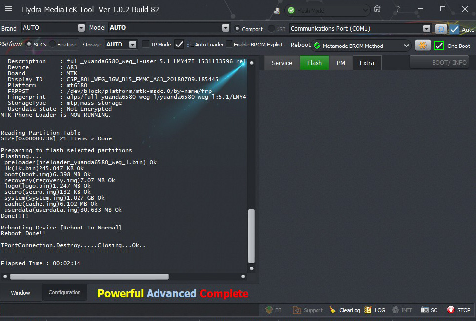

A83 u2 Cellphone successfully flashed by Hydra tool
Brand : AUTO Model : AUTO Connection : Flash Mode
How To Boot : Power off phone
* BROM Mode : Press VOL + or Press VOL -+
Connection
-Please wait...
-Connect Phone...
-Found...
-PreLoader...[COM7]
TPortConnection.Create...(COM7)..Opening...Ok
Handshaking...Ok
Identifying Hardware ID.....
BROM CPUID : 6580MT6580[6580]
Handshaking...
FUSEID : 40001002
FUSEID : 40001002
SECURE VERSION : FF
BL VERSION : 01
BR Secured : 00
Preparing Download Agent..
DA : 6580.bin
Ver : MTK_AllInOne_DA_v3.3001.2020-11-03.22:07_536568
Init : Loader [1]
Sending : Accepted
Identifying Protocol...
Protocol : Old - eMMC
0000000000000000000000000000
PRMMCCID : 45010053454D3034473A039720CE12F7
Init Configuration
Running DA 4.2 on BBID : 0x9C Ok
Initializing Loader [2]
Sending Loader [2] Accepted
Reading Flashchip data....
eMMC BOOT1 : 0x0000000000200000 -2 MB
eMMC BOOT2 : 0x0000000000200000 -2 MB
eMMC RPMB : 0x0000000000200000 -2 MB
eMMC USER : 0x00000000EC000000 -3.688 GB
ERAM Size : 0x0000000020000000 -512 MB
IRAM Size : 0x0000000000020000 -128 KB
UNICAL RID : 32C3DDED5C877A27BD726E899A03E82F
eMMC CID : 5300014534304D4597033A47F712CE20
Change to HIGH SPEED...
5A
Connection
-Please wait...
-Found...[COM14]
Reading Partition Table
SIZE[0x00000738] 21 Items > Done
Reading System Info
Brand : A83
Vendor : A83
Model : U2
SDK : 22
Release : 5.1
ABI : armeabi-v7a
Description : full_yuanda6580_weg_l-user 5.1 LMY47I 1531133596 release-keys
Device : A83
Board : MTK
Display ID : C5P_80L_WEG_3GW_B15_EMMC_A83_20180709.185445
Platform : mt6580
FRPPST : /dev/block/platform/mtk-msdc.0/by-name/frp
Fingerprint : alps/full_yuanda6580_weg_l/yuanda6580_weg_l:5.1/LMY47I/1531133596:user/release-keys
StorageType : mtp,mass_storage
Preparing to flash selected partitions
Flashing....
preloader(preloader_yuanda6580_weg_l.bin) Ok
lk(lk.bin)245.047 KB Ok
boot(boot.img)6.398 MB Ok
recovery(recovery.img)7.07 MB Ok
logo(logo.bin)1.247 MB Ok
secro(secro.img)132 KB Ok
system(system.img)1.027 GB Ok
cache(cache.img)6.102 MB Ok
userdata(userdata.img)30.633 MB Ok
Done!!!!
Reboot Done!!
Elapsed Time : 00:02:14
