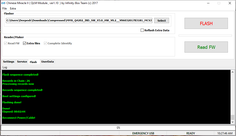

Micromax Q4202 Dead Recover Flash With Cm2
Deepesh Sharma
Apr 4, 2017
1,712
3,162
100.1614172
Micromax Q440 Repair Security
Chinese Miracle II [MTK module] v 1.58
Operation : Repair Security [ v1.58 ]
Wait for phone...
Phone found! [ 79 ]
Sync...
Inital Boot Ok!
BB_CPU_PID : 6582
BB_CPU_NME : [MediaTek] MT6582_S00
BB_CPU_EXT : 0xCB00 , 0x8A00 , 0x0000
Processing BROM stage
Settings for BROM configured!
SecCfgVal : 0x00000000
BromVer : 0x00FF
BLVersion : 0x0001
Processing DA stage
Sending and initialize DA ...
Running DA ver.4.2 on BBID : 0x87
NAND Flash : NOT INSTALLED
eMMC Flash : 90014A4838473165050781A1C90262D5
Initialize Memory ...
DAgent sent , init HW now
eMMC FlashIC initialized
[eMMC] : FLASH_INF : [HYNIX] , e1G8
[eMMC] : FLASH_CID : 90014A4838473165050781A1C90262D5
[eMMC] : FLASH_BRT : 0x00400000 , 0x00400000 , 0x00400000
[eMMC] : FLASH_LEN : 0x00000001D2000000
[eMMC] : FLASH_UCP : 7456 MiB [eMMC 8 GiB]
DEV RID : 0x4AD5A99B7F4749247E75A1B351722E7C
INT RAM : 0x00020000
EXT RAM : 0x40000000 [1 GiB]
BOOT TYPE : EMMC_FLASH_BOOT
SOC VERIFY : C1
Boot Ok!
Set IMEI [00] : 911****************
Set IMEI [01] : 911****************
Prepare finished. Security check required!
Wait for phone...
Phone found! [ 79 ]
Sync...
Repair done!
Done!
Elapsed: 00:00:44
Reconnect Power/Cable!
Deepesh Sharma
Apr 4, 2017
1,712
3,162
100.1614172
Gionee P6 Dead Recover
Card found : S/N : 32839D89 , v0136
Scatter Load Ok , BaseBand : MT6582 , Project : gionee82_cwet_kk , Storage : EMMC
Files found : 14 , Set to Flash : 13
Ready to Flash!
Operation : Flash [ v1.58 ]
======= Flash
Wait for phone...
Device boot not done
Check Drivers
Try again
Boot Error!
Operation Failed
Elapsed: 00:00:29
======= Flash
Wait for phone...
Phone found! [ 11 ]
Sync...
Inital Boot Ok!
BB_CPU_PID : 6582
BB_CPU_EXT : 0xCA01 , 0x8A00 , 0x0000
BromVer : 0x00FF
BLVersion : 0x0001
Processing DA stage
eMMC Flash : 150100513732534D42007E47D29DC215
[eMMC] : FLASH_VEN : 0x15 , OEM : 0100
[eMMC] : FLASH_INF : [SAMSUNG] , BMS27
[eMMC] : FLASH_CID : 150100513732534D42007E47D29DC215
[eMMC] : FLASH_BRT : 0x00400000 , 0x00400000 , 0x00080000
DEV RID : 0x4AD5A99B34E97ECFBAA692C88A43D85E
SOC VERIFY : C1
Boot Ok!
ScatCFG : BaseBand : MT6582 , Project : gionee82_cwet_kk , Storage : EMMC
Setting : Flash Pre-Erase (Safe) : Enabled
Setting : AFF verify : Enabled
Setting : HW verify : Enabled
BL : Check HW compatibility
BL : BBID supported by BootLoader!
BL : Check eMMC compatibility
BL : eMMC supported by BootLoader!
BL : BatteryLevel : 3675 mV
BL : BatteryLevel Ok
BL : Flash Pre-Erase
