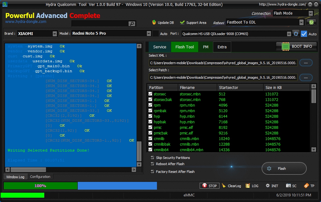

Solved ʀᴇᴅᴍɪ ɴᴏᴛᴇ 5 ᴘʀᴏ sᴛᴏᴄᴋ ʀᴏᴍ ᴀɴᴅ ғʟᴀsʜɪɴɢ sᴛᴜᴄᴋ ᴏɴ ᴍɪ ʟᴏɢᴏ ᴅᴏɴᴇ ʜʏᴅʀᴀ ᴛᴏᴏʟ
This topic has been solved
May 19, 2017
10
9
india
hasankhan71
100.1662161
Hydra Qualcomm Tool Ver 1.0.0 Build 97
Windows 10 (Version 10.0, Build 17763, 32-bit Edition)
*** Dongle Info ***
Version : Hydra Tool v 1.1
Serial : 190300000264
Initialize : OKAY
Status : Activated
Selected Comport : Auto
Selected Loader : mi_2_9.elf
Searching Qualcomm 9008 Port[FOUND](COM65)
Getting device info.......
Serial No.: 0xCDB8E688
MSM ID : 0x000CC0E1
PBL Ver : 00000003
PK HASH : A7B8B82545A98ECA23D6E9105FB464568D1B5828264903441BDEF0CD57E3C370
Sending Firehose Loader[mi_2_9.elf]
Binary build date: Aug 2 2018 @ 22:27:53
<?xml version="1.0" encoding="UTF-8" ?>
<data>
<log value="Chip serial num: 4294967295 (0xffffffff)"/>
</data>
<data>
<log value="Supported Functions: program configure nop sig firmwarewrite patch setbootablestoragedrive ufs emmc power benchmark read getstorageinfo getsha256digest erase "/>
</data>
Ok
Connecting to Firehose...
Ping......Ok
Configuration......Ok
Chip Configuration :
MemoryName : eMMC
MaxPayloadSizeToTargetInBytes : 8192
MaxPayloadSizeToTargetInBytesSupported : 8192
MaxXMLSizeInBytes : 4096
TargetName : MSM8996
Version : 1
DateTime : Aug 2 2018 - 22:27:53
* STORAGE DEVICE INFO *
Memory Type : eMMC
Block Size in Bytes : 512
Page Size : 512
Manufacturer ID : 21
Serial Number : 3283143222
Firmware Version : 5
Product Name : 3H6CMB
Physical Partitions : 4
Total Logical Blocks:
Storage [0] 122142720[58.242 GB]
Storage [1] 8192[4 MB]
Storage [2] 8192[4 MB]
Storage [3] 8192[4 MB]
Running : Ok
Phone Information........
Model :
Brand :
Android Ver :
Board :
Display ID :
Security Patch :
Emmc_size :
Platform :
Kernel ID :
Marketname :
OTA Version Name :
SYS USB CONFIG :
FRPPST :
Writing Selected Partitions
storsec -storsec.mbn Ok
storsecbak -storsec.mbn Ok
rpm -rpm.mbn Ok
rpmbak -rpm.mbn Ok
hyp -hyp.mbn Ok
hypbak -hyp.mbn Ok
pmic -pmic.elf Ok
pmicbak -pmic.elf Ok
cmnlib -cmnlib.mbn Ok
cmnlibbak -cmnlib.mbn Ok
cmnlib64 -cmnlib64.mbn Ok
cmnlib64bak -cmnlib64.mbn Ok
abl -abl.elf Ok
ablbak -abl.elf Ok
devcfgbak -devcfg.mbn Ok
devcfg -devcfg.mbn Ok
tz -tz.mbn Ok
tzbak -tz.mbn Ok
mdtpsecapp -mdtpsecapp.mbn Ok
mdtpsecappbak -mdtpsecapp.mbn Ok
keymaster -keymaster.mbn Ok
keymasterbak -keymaster.mbn Ok
bluetooth -BTFM.bin Ok
xbl -xbl.elf Ok
xblbak -xbl.elf Ok
misc -misc.img Ok
dsp -dspso.bin Ok
mdtp -mdtp.img Ok
splash -splash.img Ok
persist -persist.img Skipped
modem -NON-HLOS.bin Ok
boot -boot.img Ok
recovery -recovery.img Ok
cache -cache.img Ok
system -system.img Ok
vendor -vendor.img Ok
cust -cust.img Ok
userdata -userdata.img Ok
PrimaryGPT -gpt_main0.bin Ok
BackupGPT -gpt_backup0.bin Ok
Writting : [patch0]
[NUM_DISK_SECTORS-34.] OK
[NUM_DISK_SECTORS-1.] OK
[NUM_DISK_SECTORS-33.] OK
[CRC32(2,8192)] OK
[CRC32(NUM_DISK_SECTORS-33.,8192)] OK
[0] OK
[CRC32(1,92)] OK
[0] OK
[CRC32(NUM_DISK_SECTORS-1.,92)] OK
Writing Selected Partitions Done!
Elapsed Time : 00:07:51
