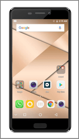

Micromax Q4310 (Android 7.0) Frp Romove 100% Done
