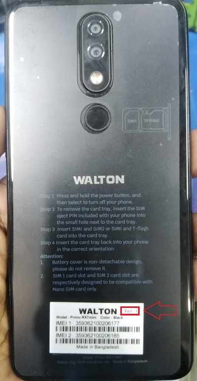

Primo_RX7_Mini_V16_05032020
Download
Download

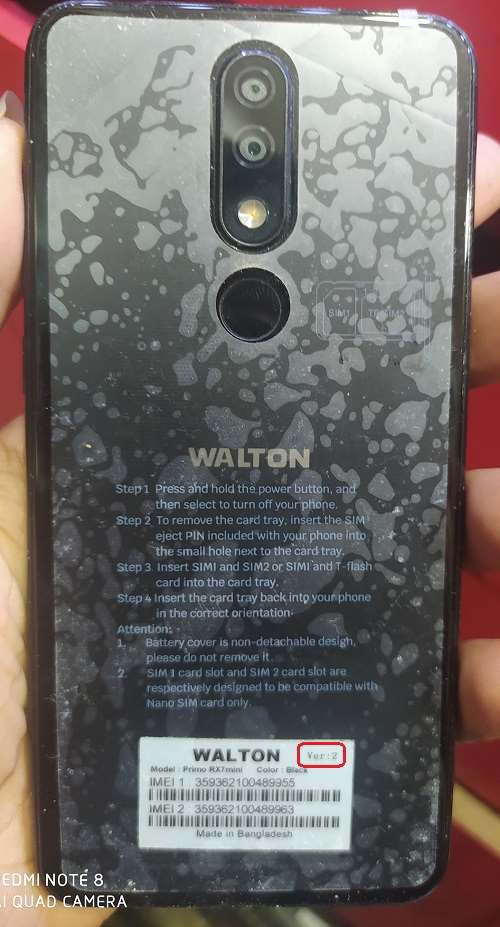

Ver: 2
Download
