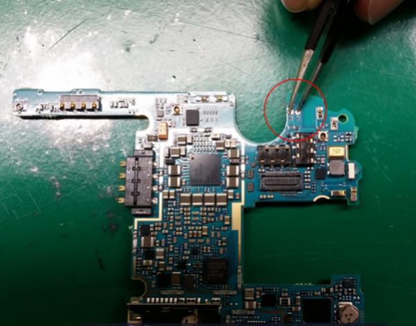

I followed this Tutorial with my dead LG G4 Qualcomm 9008 but unfortunately i didn't succeed, so here I describe what i do and please correct me If I'm Wrong
1- ONLY connect Smartphone USB Side like this :
2- Shortcut with tweezers the two testpoints as described here :
3-On windows 10 x64 Launch QFIL V 2.0.0.5 with Admin Rights :

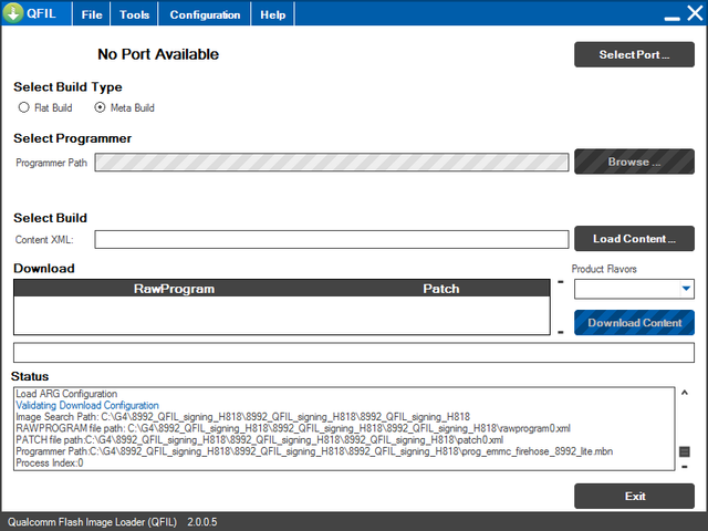

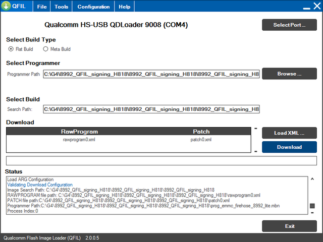

upload image
4- Connect USB Computer side
5-Choose COM PORT and all settings like this :
upload image
6-Clik Download Button
7- unsuccessful operation, this is the log file

QSAHARASERVER CALLED LIKE THIS: 'C:\Program Files (x86)\Qualcomm\QPST\bin\QSaharaServer.exe -p \\.\COM4 -s 13:C:\G4\8992_QFIL_signing_H818\8992_QFIL_signing_H818\8992_QFIL_signing_H818\prog_emmc_firehose_8992_lite.mbn 'Current working dir: C:\Users\Amine\AppData\Roaming\Qualcomm\QFIL
Sahara mappings:
2: amss.mbn
6: apps.mbn
8: dsp1.mbn
10: dbl.mbn
11: osbl.mbn
12: dsp2.mbn
16: efs1.mbn
17: efs2.mbn
20: efs3.mbn
21: sbl1.mbn
22: sbl2.mbn
23: rpm.mbn
25: tz.mbn
28: dsp3.mbn
29: acdb.mbn
30: wdt.mbn
31: mba.mbn
13: C:\G4\8992_QFIL_signing_H818\8992_QFIL_signing_H818\8992_QFIL_signing_H818\prog_emmc_firehose_8992_lite.mbn
09:28:26: Requested ID 13, file: "C:\G4\8992_QFIL_signing_H818\8992_QFIL_signing_H818\8992_QFIL_signing_H818\prog_emmc_firehose_8992_lite.mbn"
09:28:26: 273568 bytes transferred in 0.360000 seconds (0.7247MBps)
09:28:26: File transferred successfully
NOTE: Target requested image 13 which is DeviceProgrammer. Forcing QUIT. This is by design, ** All is well ** SUCCESS!!
09:28:26: Sahara protocol completed
Sending Programmer Finished
Switch To FireHose
Wait for 3 seconds...
Max Payload Size to Target:49152 Bytes
Device Type:eMMC
Platform:8x26
Disable Ack Raw Data Every N Packets
Skip Write:False
Always Validate:False
Use Verbose:False
Binary build date: Sep 28 2015 @ 17:28:46
Build version: 15.09.28.17.28.46
09:28:30: INFO: FH_LOADER WAS CALLED EXACTLY LIKE THIS
C:\Program Files (x86)\Qualcomm\QPST\bin\fh_loader.exe --port=\\.\COM4 --sendxml=rawprogram0.xml --search_path=C:\G4\8992_QFIL_signing_H818\8992_QFIL_signing_H818\8992_QFIL_signing_H818 --noprompt --showpercentagecomplete --zlpawarehost=1 --memoryname=eMMC
09:28:30: INFO: Current working dir (cwd): C:\Users\Amine\AppData\Roaming\Qualcomm\QFIL\
09:28:30: INFO: Showing network mappings to allow debugging
09:28:30: INFO:
09:28:30: INFO: Trying to store 'rawprogram0.xml' in string table
09:28:30: INFO: Looking for file 'rawprogram0.xml'
09:28:30: INFO: User wants to talk to port '\\.\COM4'
_____
| ___|
| |__ _ __ _ __ ___ _ __
| __| '__| '__/ _ \| '__|
| |__| | | | | (_) | |
\____/_| |_| \___/|_|
09:28:40: {ERROR: It took 10.00000000 seconds to open port. Which is longer than 3.000. This indicates your target is not stable}
Writing log to 'C:\Users\Amine\AppData\Roaming\Qualcomm\QFIL\port_trace.txt', might take a minute
Log is 'C:\Users\Amine\AppData\Roaming\Qualcomm\QFIL\port_trace.txt'
Download Fail:FireHose Fail FHLoader Fail:Process fail
Finish Download
09:28:30: DEBUG: Binary build date: Sep 28 2015 @ 17:28:46
09:28:30: DEBUG: Build Version: 15.09.28.17.28.46
09:28:30: DEBUG: Les nouvelles connexions seront m‚moris‚es.
09:28:30: DEBUG:
09:28:30: DEBUG: La liste est vide.
09:28:30: DEBUG:
09:28:30: INFO:
09:28:30: DEBUG: ==================================================================================
09:28:30: DEBUG: 1. Calling stat(C:\G4\8992_QFIL_signing_H818\8992_QFIL_signing_H818\8992_QFIL_signing_H818\rawprogram0.xml')
09:28:30: DEBUG: 2. Calling fopen('C:\G4\8992_QFIL_signing_H818\8992_QFIL_signing_H818\8992_QFIL_signing_H818\rawprogram0.xml') with AccessMode='rb'
09:28:30: DEBUG: Trying get filesize, calling fseek()
09:28:30: DEBUG: Found 'C:\G4\8992_QFIL_signing_H818\8992_QFIL_signing_H818\8992_QFIL_signing_H818\rawprogram0.xml' (5089 bytes)
09:28:30: DEBUG: 2. Calling fopen('C:\G4\8992_QFIL_signing_H818\8992_QFIL_signing_H818\8992_QFIL_signing_H818\rawprogram0.xml') with AccessMode='r'
09:28:30: DEBUG: User set ZLPAWAREHOST to 1
09:28:40: DEBUG: port_fd=0xC8
_____
| ___|
| |__| | | | | (_) | |
09:28:40: {ERROR: OpenPort:5566 It took 10.00000000 seconds to open port. Which is longer than 3.000. This indicates your target is not stable
So please where I'm wrong ?
Thank you.
