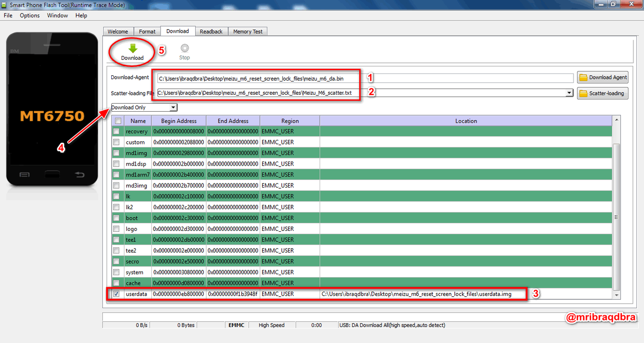

Requirements:
1.MTK Drivers
2.Flashtool
3.userdata.img
4.Meizu M6 scatter.txt
5.Meizu M6 da.bin
Make sure! your current version is 'Flyme 6.2.0.2G' or downgrade to version
'Flyme 6.2.0.2G'
keep this in mind!
Your data will be erased!
[/COLOR
Picture is explaining the process:
