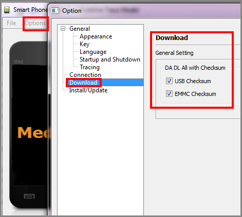

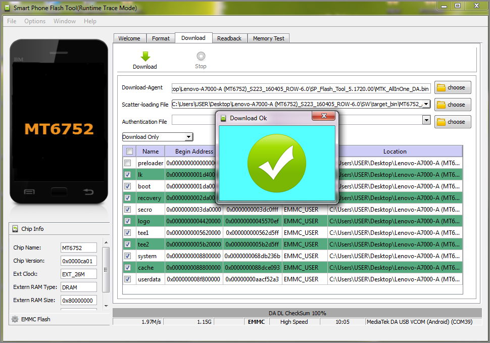

In SPFT Must Tick DA DL All with Checksum
Untick Preloader Then Flash
You Can Use Latest Version :
A7000-a_S228_160621_ROW
File Password : lenovo-forums.ru
SP_Flash_Tool_5.1720.00
