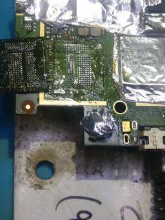

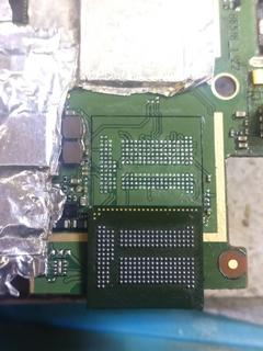

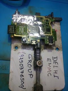

lenovo a6000dead,
only 9008 port fix ,
unable tp connect with isp ,
remove glued ic and programme with easy jtag plus.
1. health report bad
8/24/2018 2:33:16 PM> EMMC Device Information :
8/24/2018 2:33:16 PM> EMMC CID: 90014A484147326505075925F0303259
8/24/2018 2:33:16 PM> EMMC CSD: D02701320F5903FFFFFFFFEF8A4040D3
8/24/2018 2:33:16 PM> EMMC Manufacture Name: SKHYNIX , EMMC NAME: HAG2e , EMMC NAME (HEX): 484147326500 , S/N: 5925F030 , rev. 0x07
8/24/2018 2:33:16 PM> EMMC Manufacture ID: 0x90 , OEM ID: 0x4A , Device Type: BGA (Discrete embedded) , Manufacture Date: 3/2015
8/24/2018 2:33:16 PM> EMMC ROM 1 (Main User Data) Capacity: 15032 MB (0003AB800000)
8/24/2018 2:33:16 PM> EMMC ROM 2/3 (Boot Partition 1/2) Capacity: 4096 KB (000000400000)
8/24/2018 2:33:16 PM> EMMC RPMB (Replay Protected Memory Block) Capacity: 4096 KB (000000400000)
8/24/2018 2:33:16 PM> EMMC Permanent Write Protection: No
8/24/2018 2:33:16 PM> EMMC Temporary Write Protection: No
8/24/2018 2:33:16 PM> Extended CSD Information :
8/24/2018 2:33:16 PM> Extended CSD rev: 1.7 (MMC 5.0, MMC 5.01)
8/24/2018 2:33:16 PM> Boot configuration [PARTITION_CONFIG]: 0x00 , Boot from: no boot
8/24/2018 2:33:16 PM> Boot Bus Config: 0x00 , width 1bit
8/24/2018 2:33:16 PM> H/W Reset Function [RST_N_FUNCTION]: 0x00, RST_n signal is temporarily disabled
8/24/2018 2:33:16 PM> Supported partition features [PARTITIONING_SUPPORT]: 0x07
8/24/2018 2:33:16 PM> Device supports partitioning features
8/24/2018 2:33:16 PM> Device can have enhanced technological features in partitions and user data area
8/24/2018 2:33:16 PM> Device can have extended partitions attribute
8/24/2018 2:33:16 PM> Partition Settings [PARTITION_SETTING_COMPLETED]: 0x00
8/24/2018 2:33:16 PM> Backup saved: HAG2e_5925F030_20180824_143316.extcsd
8/24/2018 2:33:16 PM> EMMC Init completed.
8/24/2018 2:33:16 PM> Warning: Health report is very BAD
8/24/2018 2:33:16 PM> Device Life Time Estimation (MLC) [269]: 0x0B Exceeded its maximum estimated device life time
8/24/2018 2:33:16 PM> Device Life Time Estimation (SLC) [268]: 0x01 0% - 10% device life time used
8/24/2018 2:33:16 PM> Pre EOL information [267]: 0x03 Urgent
8/24/2018 2:33:16 PM> Scanning soft partitions
8/24/2018 2:33:17 PM> Partition table not found

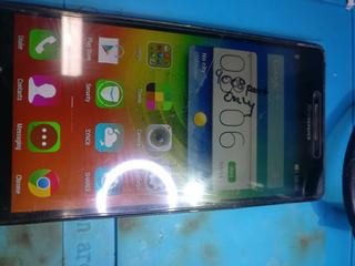

2.programmed successfully
8/24/2018 3:22:21 PM> Setting interface to EasyJtag2/E-Socket
8/24/2018 3:22:21 PM> Setting bus width to 1 Bit
8/24/2018 3:22:21 PM> Setting frequence to 42 Mhz
8/24/2018 3:22:21 PM> eMMC Init returned = 0
8/24/2018 3:22:21 PM> EMMC Device Information :
8/24/2018 3:22:21 PM> EMMC CID: 90014A484147326505075925F0303259
8/24/2018 3:22:21 PM> EMMC CSD: D02701320F5903FFFFFFFFEF8A4040D3
8/24/2018 3:22:21 PM> EMMC Manufacture Name: SKHYNIX , EMMC NAME: HAG2e , EMMC NAME (HEX): 484147326500 , S/N: 5925F030 , rev. 0x07
8/24/2018 3:22:21 PM> EMMC Manufacture ID: 0x90 , OEM ID: 0x4A , Device Type: BGA (Discrete embedded) , Manufacture Date: 3/2015
8/24/2018 3:22:21 PM> EMMC ROM 1 (Main User Data) Capacity: 15032 MB (0003AB800000)
8/24/2018 3:22:21 PM> EMMC ROM 2/3 (Boot Partition 1/2) Capacity: 4096 KB (000000400000)
8/24/2018 3:22:21 PM> EMMC RPMB (Replay Protected Memory Block) Capacity: 4096 KB (000000400000)
8/24/2018 3:22:21 PM> EMMC Permanent Write Protection: No
8/24/2018 3:22:21 PM> EMMC Temporary Write Protection: No
8/24/2018 3:22:21 PM> Extended CSD Information :
8/24/2018 3:22:21 PM> Extended CSD rev: 1.7 (MMC 5.0, MMC 5.01)
8/24/2018 3:22:21 PM> Boot configuration [PARTITION_CONFIG]: 0x38 , Boot from: ROM1 (Main User Area)
8/24/2018 3:22:21 PM> Boot Bus Config: 0x00 , width 1bit
8/24/2018 3:22:21 PM> H/W Reset Function [RST_N_FUNCTION]: 0x01, RST_n signal is permanently enabled
8/24/2018 3:22:21 PM> Supported partition features [PARTITIONING_SUPPORT]: 0x07
8/24/2018 3:22:21 PM> Device supports partitioning features
8/24/2018 3:22:21 PM> Device can have enhanced technological features in partitions and user data area
8/24/2018 3:22:21 PM> Device can have extended partitions attribute
8/24/2018 3:22:21 PM> Partition Settings [PARTITION_SETTING_COMPLETED]: 0x01
8/24/2018 3:22:21 PM> Backup saved: HAG2e_5925F030_20180824_152221.extcsd
8/24/2018 3:22:21 PM> EMMC Init completed.
8/24/2018 3:22:22 PM> Scanning soft partitions
8/24/2018 3:22:22 PM> GPT header is found and is valid
8/24/2018 3:22:22 PM> Partition: modem, [000004000000 - 000008000000], size: 000004000000
8/24/2018 3:22:22 PM> Partition: sbl1, [000008000000 - 000008080000], size: 000000080000
8/24/2018 3:22:22 PM> Partition: sbl1bak, [000008080000 - 000008100000], size: 000000080000
8/24/2018 3:22:22 PM> Partition: aboot, [000008100000 - 000008200000], size: 000000100000
8/24/2018 3:22:22 PM> Partition: abootbak, [000008200000 - 000008300000], size: 000000100000
8/24/2018 3:22:22 PM> Partition: rpm, [000008300000 - 000008380000], size: 000000080000
8/24/2018 3:22:22 PM> Partition: rpmbak, [000008380000 - 000008400000], size: 000000080000
8/24/2018 3:22:22 PM> Partition: tz, [000008400000 - 000008480000], size: 000000080000
8/24/2018 3:22:22 PM> Partition: tzbak, [000008480000 - 000008500000], size: 000000080000
8/24/2018 3:22:22 PM> Partition: hyp, [000008500000 - 000008580000], size: 000000080000
8/24/2018 3:22:22 PM> Partition: hypbak, [000008580000 - 000008600000], size: 000000080000
8/24/2018 3:22:22 PM> Partition: pad, [000008600000 - 000008700000], size: 000000100000
8/24/2018 3:22:22 PM> Partition: modemst1, [000008700000 - 000008880000], size: 000000180000
8/24/2018 3:22:22 PM> Partition: modemst2, [000008880000 - 000008A00000], size: 000000180000
8/24/2018 3:22:22 PM> Partition: misc, [000008A00000 - 000008B00000], size: 000000100000
8/24/2018 3:22:22 PM> Partition: fsc, [000008B00000 - 000008B00400], size: 000000000400
8/24/2018 3:22:22 PM> Partition: ssd, [000008B00400 - 000008B02400], size: 000000002000
8/24/2018 3:22:22 PM> Partition: splash, [000008B02400 - 000009502400], size: 000000A00000
8/24/2018 3:22:22 PM> Partition: DDR, [00000C000000 - 00000C008000], size: 000000008000
8/24/2018 3:22:22 PM> Partition: fsg, [00000C008000 - 00000C188000], size: 000000180000
8/24/2018 3:22:22 PM> Partition: sec, [00000C188000 - 00000C18C000], size: 000000004000
8/24/2018 3:22:22 PM> Partition: boot, [00000C18C000 - 00000E18C000], size: 000002000000
8/24/2018 3:22:22 PM> Partition: system, [00000E18C000 - 00007E98C000], size: 000070800000
8/24/2018 3:22:22 PM> Partition: persist, [00007E98C000 - 00008098C000], size: 000002000000
8/24/2018 3:22:22 PM> Partition: cache, [00008098C000 - 000090F8C000], size: 000010600000
8/24/2018 3:22:22 PM> Partition: recovery, [000090F8C000 - 000092F8C000], size: 000002000000
8/24/2018 3:22:22 PM> Partition: keystore, [000094000000 - 000094080000], size: 000000080000
8/24/2018 3:22:22 PM> Partition: config, [000094080000 - 000094088000], size: 000000008000
8/24/2018 3:22:22 PM> Partition: oem, [000094088000 - 000098088000], size: 000004000000
8/24/2018 3:22:22 PM> Partition: userdata, [00009C000000 - 0003AB7FBE00], size: 00030F7FBE00
8/24/2018 3:22:22 PM> GPT header successfully parsed
8/24/2018 3:22:22 PM> Get firmware version
8/24/2018 3:22:22 PM> Brand = Lenovo
8/24/2018 3:22:22 PM> Manufacturer = LENOVO
8/24/2018 3:22:22 PM> Model = Lenovo A6000
8/24/2018 3:22:22 PM> Phone platform = msm8916
8/24/2018 3:22:22 PM> CPU Abi = armeabi-v7a
8/24/2018 3:22:22 PM> Android release = 4.4.4
8/24/2018 3:22:22 PM> Firmware version = Kraft-A6000_S035_150507
8/24/2018 3:22:22 PM> Firmware date = 2015? 05? 07? ??? 16:21:40 CST
