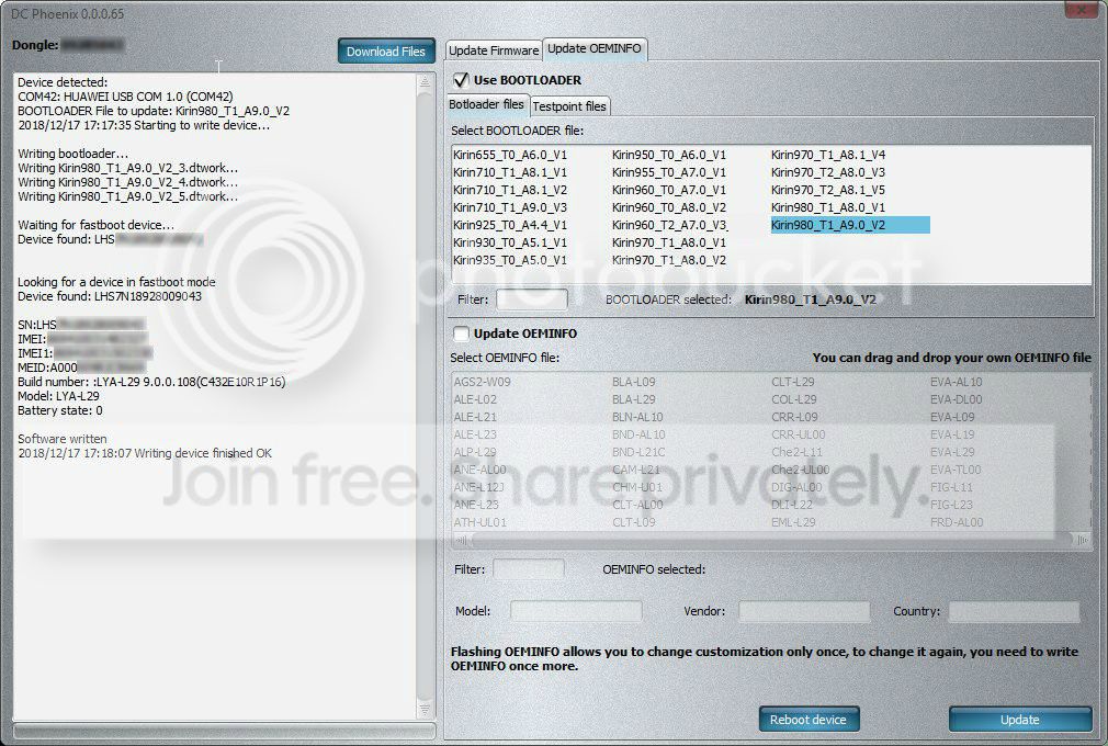

DC-Phoenix V.65 Update
New functions and features added:
OEMINFO partion writing.
Bootloader loading in Huawei 1.0 port or testpoint (now can start ram loader and fastboot alone from testpoint).
Testpoint picture automatic download.
Region conversion, demo conversion for many phones included P20, P20 pro and other.
Supported Hisilicon CPU's for testpoint and loader:
Kirin655
Kirin710
Kirin925
Kirin930
Kirin935
Kirin950
Kirin955
Kirin960
Kirin970
Kirin980 (only your own OEMINFO file writing)
OEMINFO automatic download from server
Possible to use your own OEMINFO file with 'drag and drop'
Change vendor/country/model in OEMINFO (useful if phone cannot power on and you do not know correct data that belongs to it)
Automatic OEMINFO modification , for possibility to change region or to do downgrade
Model change before writing OEMINFO
For now, only HiSilicon based models supported
No need to unlock FRP or Bootloader to write OEMINFO (only for currently supported models), new security models by testpoint only
Exrtacting all partitions from Update.APP file now changed to Extract selected, where you can extract partitions of your choice
Speedup process for flashing in fastboot, no extracting to disk required anymore.

Safer procedure (OTA updates won't work):
1. Rewrite OEMINFO with correct vendor/country and model
2. Write only customization file matching details of vendor/country and model
Propper procedure:
2. Write only XLOADER partition from selected destination firmware (Advanced mode, leave check box only on one partition) and check if phone turns on afterwards, if not then flash another, until you find correct one (One that will turn on mobile)
3. Flash firmware and customization in Update mode with DC-phoenix or from SD card. (DO NOT attempt to change android version, must write same one)
Procedure is risky, adviced to attempt it only for advanced users, read and investigate as much as possible about your mobile before doing anything.
